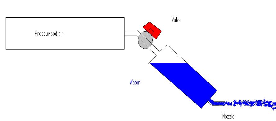

a) Don't put your ball valve on the water exaust pipe... you'll decrease the flow a lot. I recommend using the valve only to provide air from an air tank.
b) Don't put your valve somewhere awkward like that. If you want decent acceleration, you want to be able to hold on!

3a. if i dont put it at the exhuast where should i put it in order to release the water+air mixture?
b)i m thinking of making a longer wooden lever to reach the valve at the back actually.
and i am going to use class E upvc pipes. its rated to 15bar or 217psi. suppose i use a 1" nozzle.. what kind of mixture should i use? sry boilingleadbath but i was never good in maths and i dont understand the stuff u just posted.. could u do me a huge favour by calculating what kind of water/air mixture i would need with the same dimensions as the one posted above?

I think a setup like this would work best:
This is not to scale
water rocket propusion.JPG (20.49 KiB) Viewed 4240 times
