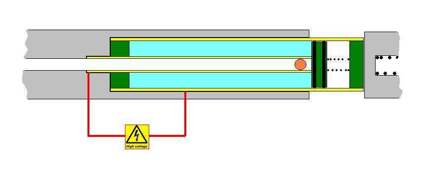

2) A properly constructed hybrid isn't going to need more than 5-10 rounds to devastate a target. Say they were constructed with a piston instead of a burst disk as per attachment, loading them would not be a problem. Also worth considering is what SPG had proposed a while back, where the projectile is the valve.
Agitating the idea in the spudfiles think-tank will doubtless facilitate matters in terms of adding simplicity ;)
Mon Sep 21, 2009 2:16 am
In terms of adding simplicity on this design, eliminate the spring in the "Pilot" and fill from the pilot. Add fuel first, add air. This purges fuel from the pilot and then brings up the chamber to pressure with the correct mix. On ignition, the sudden pressure rise opens the valve. Doesn't get much simpler.
Mon Sep 21, 2009 2:35 am
Interesting idea, you could eliminate the o-rings on the piston too. The problem though in my opinion would be guaranteeing a correct fuel-air mix in the chamber.
I think the "projectile seal" idea with no moving parts would probably be the easiest route to take however.
