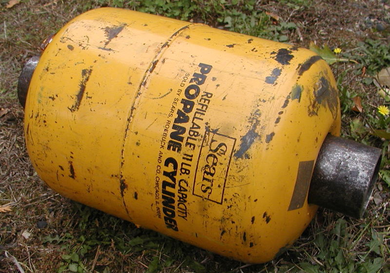

that is the exact same tank i have that you have in the photo lol but mine is yellow haha and it isn't too difficult to make into an air tank.
and how much psi can this bottle take?
