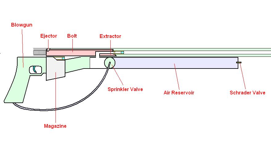

I am building a similar spud gun to yours, except the air reservoir will be in the gun and it will have a small bore, hence I will be using a sprinkler valve instead. I wish you all the best! Mazel tov!

This is the diagram of my spud gun. It is still in its early stages. The problem I have here is that the bolt is too long and ugly.
- Diagram.JPG (33.4 KiB) Viewed 13273 times

This sounds like a better idea than your previous cartridge pneumatic! I always like to see what Jack comes up with; you seem to have some of the more creative ideas around here.
Is flow going to be a problem with the cartridges? Your cartridge barrel is necessarily going to be a great deal smaller than your actual barrel, otherwise you wouldn't have much chamber volume, and would have more dead space instead. But I guess if you are working with insanely high pressure it won't be a huge deal.
Could you make a 'magnum' cartridge, so that your ammo actually goes into the cartridge barrel? The end result would be like a coaxial gun with one barrel and exchangeable chambers. I guess that wouldn't make too much sense, though: may as well have a barrel for each chamber.
