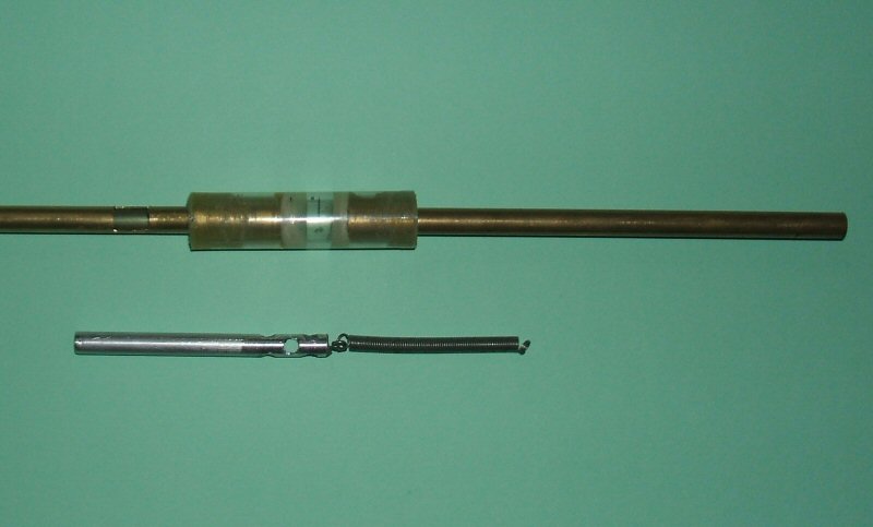

I still prefer the idea of blow-forward than blow-back, somewhat inspired by clide's GB semi I came up with the following, note that the spring is a tension one.
*update* I'm making a prototype of the attached design, should be done by tomorrow. I figure that even if it doesnt work as full auto with a constant flow, it will be a better blow forward valve than the subject of this thread due to less dead space and reduced friction since there aren't any epoxy pistons involved, just tight fitting metal-to-metal tubing.

Here's the prototype curing, it'll probably be ready for testing in a few hours.
blow forward breech version 2

IT WORKS! IT WORKS!!! FULL AUTO BABY YEAH!!!
*ahem*
yes er, it works. at least the reciprocating bolt does, it cycles full auto with a constant flow of air. I haven'te tried it with ammunition yet, frankly the bolt cycles so quickly that I don't know if gravity feed will cut it.
anyway, in my enthusiasm, the hook holding the spring to the bolt came loose (and out came the bolt flying out of the barrel lolol) so a bit of epoxying is in order, videos to be posted soon :D

Whoa! Freekin awesome, dude! At first I was like: "It's just a blow-forward, how the blazes does he think he's going to get auto-fire from it?" Took me a while to see how it worked.
It seems to me that if you run it with some ammo, the increased barrel pressure ought to slow the cycle down a bit, so maybe your grav-mag will still work. If not, you might try steel ammo and a magnet.
