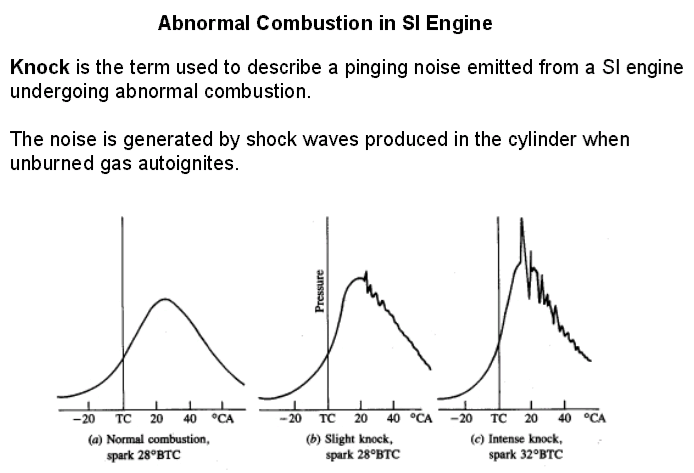

Found this from a PPT on SI engines
Note that the pressure spikes for "pinging" is only perhaps 2x the normal peak pressure.
From:
Mechanical and Materials Engineering
McLaughlin Hall, Queen's University
http://me.queensu.ca%2Fcourses%2FMECH435%2Fnotes%2FCombustion_in_IC_Engines.ppt
From http://me.queensu.ca%2Fcourses%2FMECH435%2Fnotes%2FCombustion_in_IC_Engines.ppt<br />Department of Mechanical Eng.
