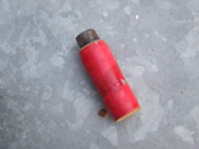

This is what I was firing. Similer to the dart but with no tail.

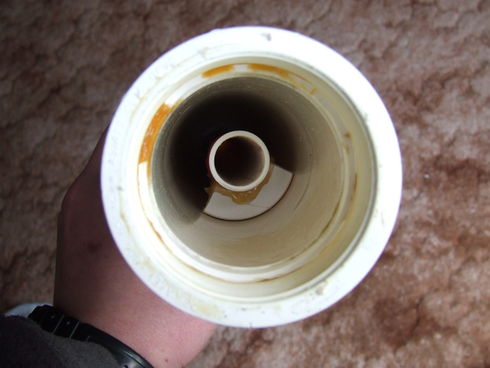

View of the inside, I just rungied up a centering device and hotglued it to the barrel, nothing fancy but it doesn't move and works well.
