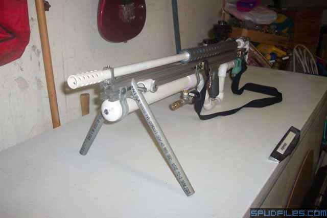

<div align="center">KANEDA'S SNIPER
Provided By - Kaneda

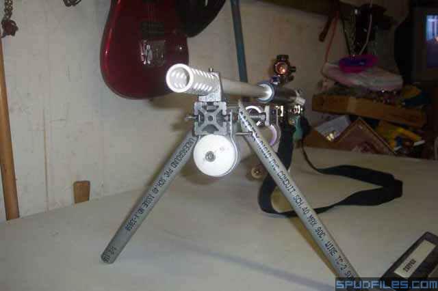

I know a lot of people arent too fond of em, but I dig em..I used an extra piece of extruded aluminum for the rifle frame. Its really handy cuz it has t slots on each side, so you can adjust/fine tune/remove or add stuff with an allen wrench. Used a 1" sprinkler valve, made a really simple bolt action breech, some cosmetic stuff..barrel shroud, flash hider.
The spring loaded bipod is 1\2" electical pvc, with locking mechanism made from bored out 1/2" sch 40 couplers, attached to some t slot nuts i made to allow sliding open or closed. The thumb screws I lathed and knurled at work. The scope mount is all that remains of my .44 Desert Eagle..sob..had to sell it a long time back..I had to machine an adapter to go from the Eagle mount to the 3/8" dovetail on the BSA red dot.

I like how you incorperated the aluminum into the stock and how it stabalizes the gun. Real ingenius, but running the air through the frame restricts flow, and is said to dangerous. I like the handle and the grey pipe with all the holes drilled in it. It makes it look more realistic

theexp wrote: running the air through the frame restricts flow, and is said to dangerous.
It doesnt really restrict flow (although the dead space reduceces proformance), and it is in no way dangerous.
Last edited by BC Pneumatics on Mon Apr 03, 2006 11:02 pm, edited 1 time in total.
saladtossser
Posts: 1234
Location: Toronto
BC is right, as a rule, my barrels must be the smallest pipe on the gun
