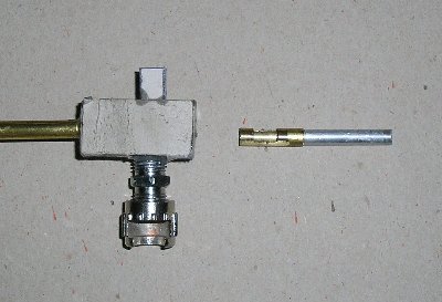

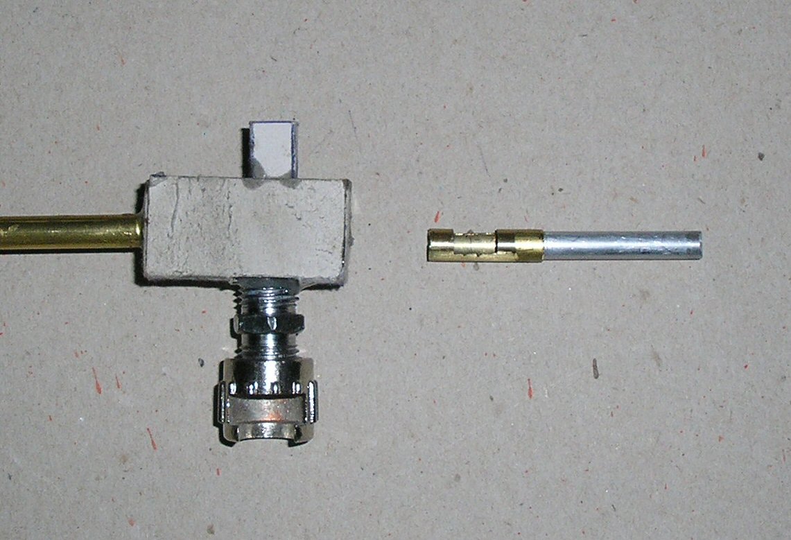

A little update, I added a threaded adapter to allow it to be hooked up to my compressor, and a length of aluminium to hallow the breech to be hooked up to an electric drill for testing. I'll give it until tomorrow to cure then you can expect some results :)

I promised you results, and the results are most disappointing. So much for tight tolerances, it leaks air like crazy, a complete waste of time. Ah well, at least I answered the nagging question in my head of whether it would work or not.
Now, the ball valve idea, hmmm...

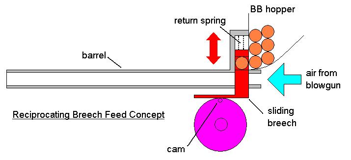

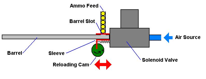

I actually have a couple of cam powered designs :)
auto concept.JPG (22.93 KiB) Viewed 3209 times

Haha, I hadn´t expected that you already had camshafts in gun designs...
It seems to be the conclusion that with our kitchen-table construction techniques, one can only make good valves iff the moving part of the valve moves perpendicular to the sealing plane...

The thing is I *really* would like to keep it air-only, without the need for an external motor to power it, which Is why I was focusing on the blow back/forward ideas.
