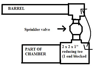

I have been finding it very difficult to find an easy way of getting from my 4" chamber down to my 1" sprinkler valve. I assumed that Home Depot would have something like a 2" x 1" reducer, but they don't. At the moment, all I can find is a 2" x 2" x 1" reducing tee. So, I have 2 questions: 1, does anyone know where you can buy a 2 x 1 reducer, (or if they exist), and is it acceptable to have all your pressurized air going around a very small (1") 90 degree corner? If I can, I only want to do extreme reducing, aka down to 1", when in a straight line. Is it ok to have escaping air (before and after the valve) go around a small corner? Thanks,

By escaping air i mean air traveling towards and away from the sprinkler valve. (from the chamber to the valve, and from the valve to the barrel) Because I simply cannot find a 2 - 1" reducer, I would have to use a 1" elbow of sorts (2x2x1 tee, with 1 2" blocked off). Can someone send me a link to a website where I can buy a 2 x 1 reducer? (I can find a 1.5 to 1, but that's it. :cry: )
This is the only way I can find to do what I want... I was hoping to do all of this in a straight line, so I can use 4&amp;quot; elbows and have maximum air flow.

its pretty simple. buy a 4x2" bushing, and a 2x1" bushing, then buy a 1" male thread fitting, and then it will screw into your sprinkler valve.

Well, I have bought everything I need for the chamber(s), and I have already bought + modded 2 1" sprinkler valves... so basically, all I need to know is how I can possibly get down to 1" from 4". Even if I had to go down by 1/2" increments, I guess it would be ok. I purchased some 1.5" to 1" reducing bushings, but I don't know if bushings are acceptable on a high-pressure system. Any know-how?

Mr.Russ wrote:its pretty simple. buy a 4x2" bushing, and a 2x1" bushing, then buy a 1" male thread fitting, and then it will screw into your sprinkler valve.
is that not enough? or am i missing something.
Thats how i did mine from 2" to 1" using a bushing, and yeh i thought they would make a 4x2" bushing aswell..

Hehe Sorry Mr. Russ I, (me being myself), managed to somehow not see your message as I scanned over the others. Thanks for the help, I think I should be good now. :D
