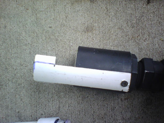

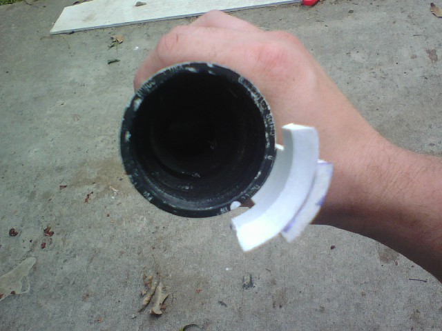

About 6 months ago, I built a pneumatic cannon. It is a 1.5" barreled cannon with a modded sprinkler valve and breech loader. It was designed primarily for paintball use and shells were loaded with sabots. I attempted to model the breech loading system after the BECC and feel that I did a pretty good job. This system did okay, that is until I went to fire a potato.
The shell was loaded, and the cannon was charged. I grabbed the beast and pulled the trigger. The potato sealed too good and the whole shell popped out of the receiver part, sliding the entire barrel forward. This may not sound bad but it did. It sounded really bad. The pressures coming from the sprinkler valve (sitting right next to my ear, of course) was so loud that my ear rang for about an hour.
This mishap caused me to redesign the breech loading system, so I did. No it works wonderfully with any type of ammo.
I am not going to post step - by - step instructions because the pictures should explain it for the most part. Any questions, just ask.
Note: The system works wonderfully with the 1.5" cannon. I don't see why it couldn't be scaled up or down to accommodate any other type of cannon as well. Okay, now for the pictures.
Another Breech Loading System
- This system allows the barrel to slide forward to open the breech. The larger coupling (2") was screwed to the 1.5" tee because it was slightly too big to use glue. The coupling was then gapped out, as shown, to allow for a locking mechanism. The tee was slit and secured to the chamber with a clamp.
