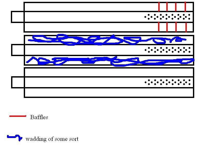

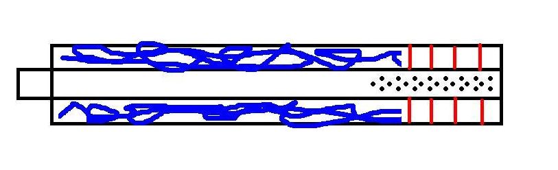

Which would work better?
keep in mind I am using the full barrel shrouding method.
Depending on your getting the wadding consistency right, this:
- Silencercomparison.jpg (26.1 KiB) Viewed 3374 times

So, the batting material only really needs to be in the largest, first baffle? Is that for conveinence or is there an actual reason behind that?
It appears in his drawing he would have a lot of small holes, will that work better than fewer bigger holes? Since he is using paintballs eventually, I am assuming he will have pretty nice spherical ammo, so the holes shouldn't cause too much of a problem on that end.

well i think its because it allows you to have a massive first chamber without drilling holes all the way up the barrel and putting baffles in because the wadding has the same effect as baffles, i think.
You could put the wadding in the forward baffles too, it's a matter of trial and error - wadding is an inexact science, depending on what materials you use and how densely you pack it, sometimes no wadding at all will give better results.williamfeldmann wrote:So, the batting material only really needs to be in the largest, first baffle? Is that for conveinence or is there an actual reason behind that?
This for example is a Logun silencer popular with airgunners in the UK:
The black wadding wraps around the perforated tube and is similar in consistency to this stuff used for washing dishes. Some users insist that it works better without it, the thing with silencers though is that it's extremely subjective, without a decibel meter it's sometimes hard to tell what actually makes a difference.
The important thing is the total area of the holes - the bigger the area, the more flow to the silencer body and the less friction with the projectile. That said, for a given area, more smaller holes could potentially create more turbulence and therefore increase the effectiveness of the silencer.t appears in his drawing he would have a lot of small holes, will that work better than fewer bigger holes?

unfortunatly i don't happen to have a decibel meter lying around so i have no way of testing
i might try a silencer design like that for my 6mm and i will use j-cloth to wrap around the spacers, my mum has tons
just make sure if your using it for a paint ball rifle that you clean the inside of the barrel after you drill it. It will have heaps of burs, I just made a dowel/sandpaper "dremel" for mine. You dont want those pbs rupturing before they get a chance to splat on something cool
