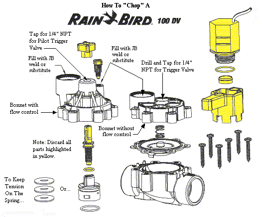

bend the top of the guide rod 90 degress about 2 cm down. and it should rest on the diagram. then get a 1/4 nipple and put it through the thick bit at the very top of the valve. this should help p.m me if you have any questions.

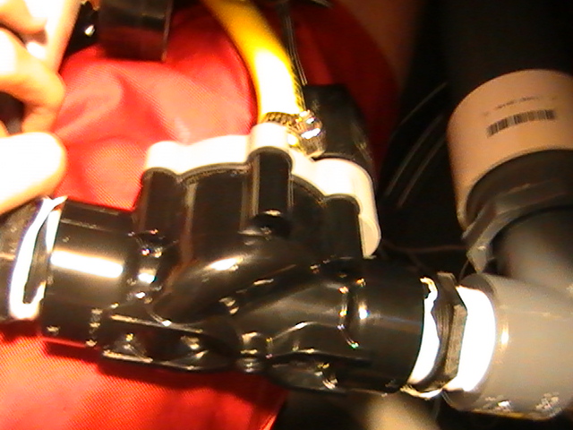

i don't know if this will help or not but it is how i did it and it worked.
ShowNoMercy
Posts: 1094
Location: Jersey Bitches!
Well how did the spring stay in place with a hole there?
Jesus saves, no need to pray
It seems you've lost your way
grumpy
Posts: 331
Location: tampa,fla.
looking at the pic, in the bottom left corner you see three washers you add these to keep tension on the spring. they are not normaly there, you can get them at any hardware store i do not remember what size though.

tell me if your valve looks like the one pictured below
if so i know the fix
yes i know its the bottom view but you can still tell

to get it not to honk you must remove the white equalization thing, but it is possible to mod it as i have done it and it works for me
