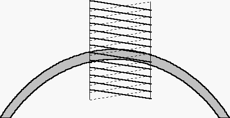

As folks have posted their are really two things you are worried about when you drill a hole for a gauge (or any other accessory).
Will the hole weaken the pipe (fitting, joint) and act as a nucleation site for a catastrophic failure of the gun?
Will the threads in the hole be strong enough to keep the gauge from being fired from the gun?
For the second question it is easy enough to test. Figure your typical "1/4 inch NPT fitting" actually uses a hole pretty close to 1/2 inch in diameter. The area of the hole is (Pi)r<sup>2</sup>=(3.14)(0.25)<sup>2</sup>=0.19in<sup>2</sup>
If you are using a shop compressor, then the maximum pressure in the chamber is about 120 PSIG. That means there is (120PSIG)(0.19in<sup>2</sup>)= ~24 pounds of force pushing on the gauge when the gun is pressurized. Really not all that much. You can grab the gauge and pull hard and easily put that much force on it. If you can rip the gauge out of the gun with you hands then the mounting probably isn't strong enough.
There are a couple reasons for drilling into joints instead of just the pipe. Strength is certainly an important one. Another reason is that you want the threads to seal. Imagine threads through a curved piece of pipe wall. If the wall thickness and diameter of the pipe is small enough then you won't have very many threads (perhaps none at all) that actually make a full revolution in contact with the pipe.

As folks have posted, there are really a couple things you are worried about when you drill a hole for a gauge (or any other accessory).
Will the threads actually create an air-tight seal?
If you are using a shop compressor, then the maximum pressure in the chamber is about 120 PSIG. That means there is (120PSIG)(0.19in<sup>2</sup>)= ~24 pounds of force pushing on the gauge when the gun is pressurized. Really not all that much. You can grab the gauge and pull hard and easily put that much force on it. If you can rip the gauge out of the gun with your hands then the mounting probably isn't strong enough.
There are a couple reasons for drilling into joints instead of just the pipe. Strength is certainly an important one. Another reason is that you want the threads to seal. Imagine threads through a curved piece of pipe wall (see the attached image "thread_in_pipe"). If the wall thickness and diameter of the pipe is small enough then you won't have very many threads (perhaps none at all) that actually make a full revolution in contact with the pipe. Without at least a couple full revolutions of the threads they won't seal very well. The double pipe thickness you get at a joint helps get more threads actually seated in the plastic. This helps both the strength and reduces leaks.
If you really want to beef up a place where you are installing a gauge you can use a triple layer of PVC. Take a piece of pipe a couple inches long and cut it in half lengthwise (so it looks like a "C"). Boil the piece in water for a minute or two then remove it from the boiling water and, while still hot, force it around the fitting on the gun and clamp in place. Let it cool to room temp. Remove the piece, dry it thoroughly (water will prevent the glue from bonding properly), prime and apply glue to both the piece and the fitting, reinstall the piece and clamp in place until the glue is dry. You need to allow at least 12 hours (24 is better) for the glue to dry. If you drill and/or tap into it before it is fully dry you'll rip the piece back off the fitting.
You now have a triple thickness of pipe wall. For 3"D sch40 PVC the triple thickness is about 0.7 inch thick.

- (Hmmm, looks like a fitting with left-handed threads.)
- thread_in_pipe.gif (3.69 KiB) Viewed 2050 times
