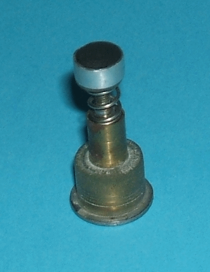

auto piston v2.0
Following the abject failure of my auto-piston prototype and the suggestions made on the thread (cheers clide :D) I've come up with a less sophisticated design as per the attached diagram.
The firing cycle is as follows:
1) the firing chamber and piston unit start to fill with compressed air
2) when the force on the piston is greater than the force provided by the spring, the piston moves down slightly
3) this movement exposes the wider section of the piston to the force of the compressed air, pushing it down allowing the chamber to vent
4) as the pressure decreases, the spring pushes the piston back up and the cycle can continue.
The theory is sound but fleshing it out in practice looks a bit tricky as is, I'm still trying to refine the idea but just thinking aloud for now.
edit: A quick sketch of a possible refinement with the piston in two parts. The breech vent is sealed by a floating component, when the chamber is pressurised the piston component is forced down, eventually pulling the floating part down with it. The chamber is vented, allowing the piston to be returned by the spring and resealed. The advantage of this system would be that the main spring doesn't have to be strong enough to overcome the pressure, just enough to overcome the friction of the piston.
edit 2: here's the above idea as an animation

looks nice as always, how in the world do you come up with all these ideas? Cant wait to see it in action.

getting the right strength of spring could be tricky, i'm guessing you want it to hold about 100psi then start venting? other than that its a sound design which will hopefully work so i can copy it :wink:

I think the floating valve is probably a little overkill. If you keep the outlet pretty close in diameter to the piston, then there won't be much force that the spring needs to hold back. Well, until it opens, but a bumper can be used to take that force rather than the spring.
clide wrote:I think the floating valve is probably a little overkill.
In that case, I'll DEFINITELY make it :D wheee!

anyway, back on topic, I think the floating piston idea thing wouldn't be too hard to make, I've already made something similar for a completely different project.

just letting you know and the piston looks professional grade although i have no idea how it works...yet
