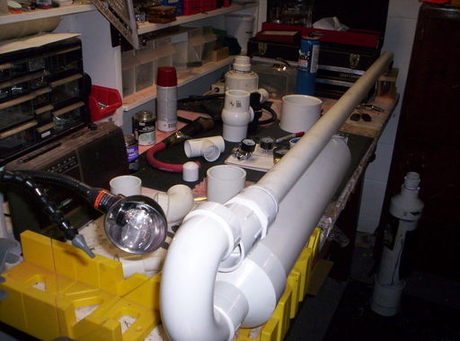

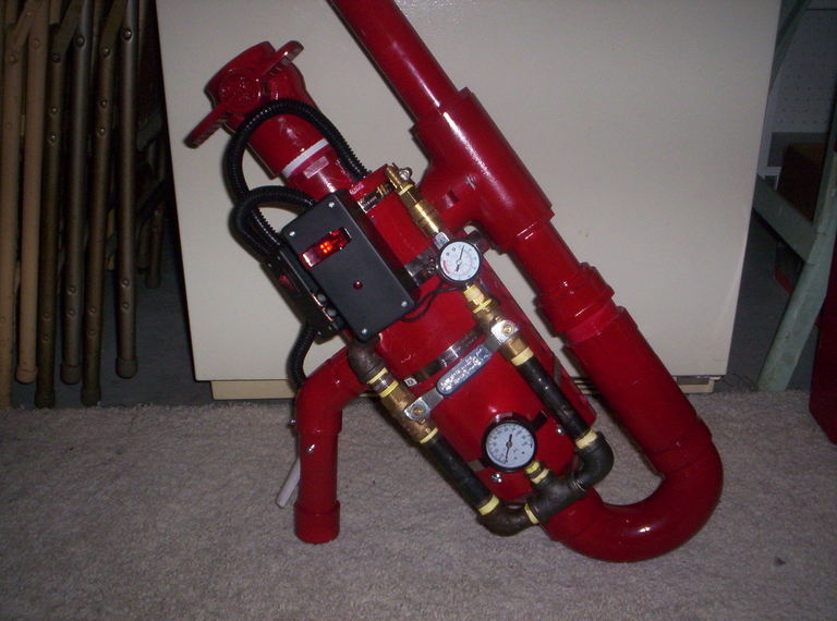

My recently completed cannon features on board metered propane injection, stun gun ignition, chamber fan, and an over/under setup.
Specs:
-Chamber is 4" diameter and 15" long
-Barrel is 1.5" x 60" long
-Over/under design
-12v intel CPU fan
-Modified stun gun ignition
-Separate control boxes for ignition and fan controls
-Innovative trigger design made from PVC, pressure switch and a spring
-Metered propane with regulator and quick disconnect safety feature
-Break barrel breech loading ability

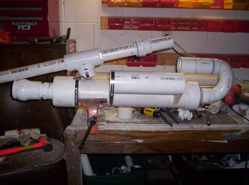

The chamber ratio is about .8-1. As you can see in the beginning stages of design, I disregarded the correct chamber ratio and my chamber was wayyy to big so I had to shorten it substantially for optimum power. The chamber is actually 4" DWV sleeved with (3) 4" couplers.
I'm sure most have seen this break barrel design on other cannons ( I cannot take credit for this idea) but I implemented it on this cannon.
I haven't had the chance to test fire it because of the bad weather we've been having but once it gets warmer I'll be able to fine tune the propane and get everything dialed in. I might add a laser sight or something because this thing weighs a ton and it's hard to aim.
Thats about it.. here's the pictures of the cannon and design process.[/i]

When you say that you shortened the chamber for optimum power, how long was it before? I am of the understanding that a bigger chamber will give MORE power, more noise and less efficiency.
Here's what the chamber was going to be in the early stage of building it. I didn't take into consideration that I need a proper C:B ratio.Novacastrian wrote:Very nice work, i would have named it the "Piece" Maker though.
When you say that you shortened the barrel for optimum power, how long was it before? I am of the understanding that a bigger chamber will give MORE power, more noise and less efficiency.
Thanks, ball valve is removable yes.nightshot wrote:Congratulations... Nice gun and the disign is awesome ;D
Is that ball valve on the chamber removable ?
good job
love the perforated propane holder
