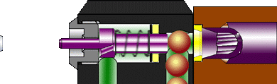

so is the bb shot with the spring or the co2?
The solenoid hits the purple valve section, which pushes a BB into the barrel and releases a burst of CO2, which fires the BB. The spring then returns the the valve, closing off the CO2 and allowing a new BB to be pushed in place.

experament-u2 wrote:i just found this ant thought it might help
i never realized the hammer and all that was part of the mag that is brilyant
Hey man thnx so much! I was looking/searching for this pic for a long time. I got how the gun worked but this makes it all more visual. I couldnt read those russian sites where it was on so I could never find the real gif.

Ok so dumb question..... how's the gas get to the barrel? I can see how the BB does, but the gas?
In this picture
I presume the solenoid taps on part 4, which moves forwards compressing spring 6 and also loading a BB. But how does the gas get round part 4? or is part 4 craftily tubular and complicatedly made?

The coloured diagram shows diagonal lines through the wider section of the valve which probably indicates a channel that runs from the back out the front, directly behind the BB. The wider section of the valve would be hollow.
