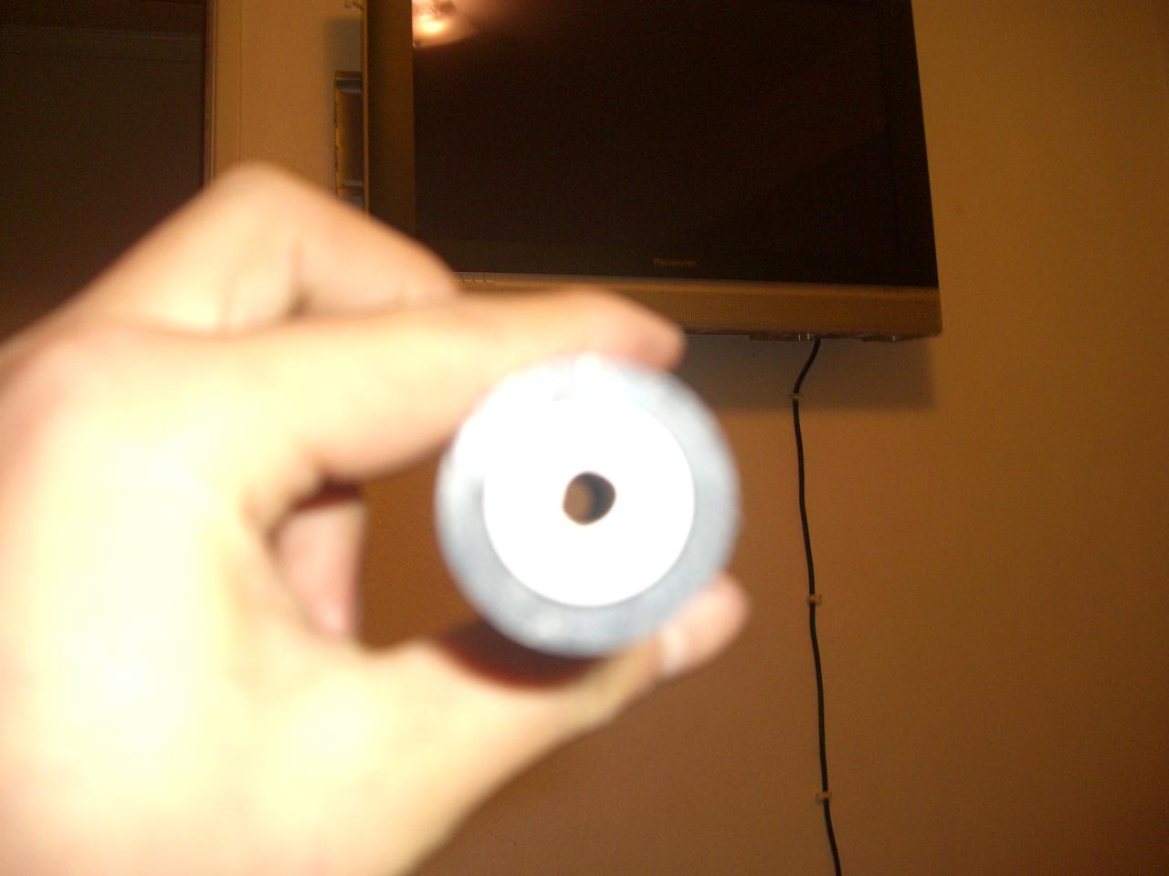

Well im not sure i can call this little thing a cannon
but what the heck. This is my smallest pneumatic its only about 3 inches long , its a coax it has a 6mm barrel for bbs the chamber is 3/4 sch80 , it is filled with a sharader valve and exhausted with the sharader valve , its runs at about 100-170 psi. oh and the sealing face is mousepad everythings held in with epoxy ,hope you guys like
Nice, but show a pic of the barrel.

about the performance of an airsoft springer
haha but a tiny tiny tiny tiny bit better
