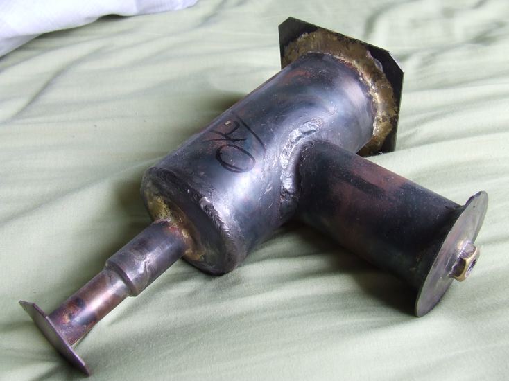

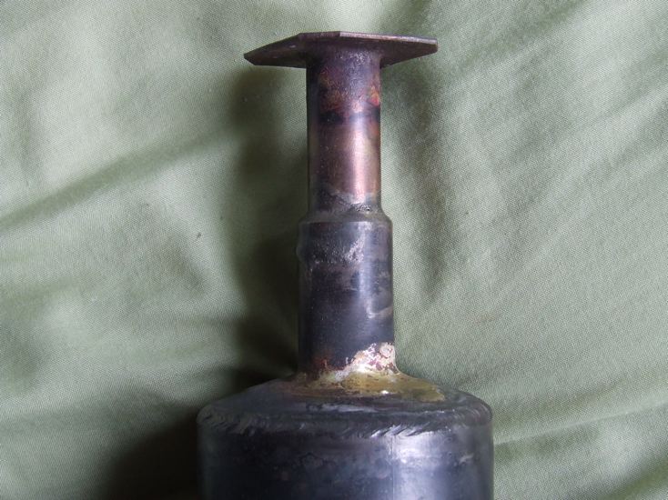

I made this test piece in a metalwork class. It is a few pipes welded/brazed together in various ways. The main body is just normal steel pipe, with a seam. The end bits on the wide pipe are just steel plate which has been butt welded, with a mixture of brass brazing and the others just melted steel/filler rod. One has a brass nut brazed onto the outside with Silfos, which is a faily low temp brazing product for brass and copper ( cant remember exactly which is used cus made it a while back) Up the top there is a copper pipe with a piece of flat copper butt brazed to the end of it, not a cap, just a flat piece of copper. It was dones with silfos, or silver solder, one of them lol.
Anyway, the thing was filled with water and a pump attaced to the brass nut. It was then pumped up to 1800psi, which is pretty high, the flat plates that were butt welded on all bowed out because of the pressure, but the thing held. Only had one tiny pinhole leak. Im not sure it it would be the same as with air, but I dont see why not. If done correctly, brazing/soldering creates a very strong joint. This was all done with a oxy acet torch.
