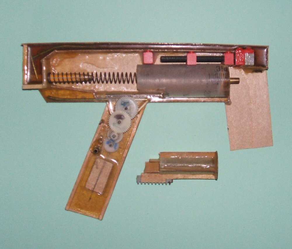

If only we could make this ............ Has any one tried at all ........... HAs any aussies tried to import this from the uk or usa as a spare part or something .....

Getting the teeth right and everything is not simple if you dont have a laith or good machenery. I had once of these gearboxes before and tried to fix it as one of the gears was worn down. I ended up not being able to fix it as everypart needed to be exact and perfect fit''. If I were you I would think of a way to power ur newest creation using a motor. It would be really easy using a cam or something. I have tried it and it does work its just that I want a airgun that works on 100% air now lol.

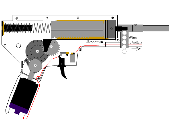

the main gear that pulls the piston back is simply a rack-and-pinion. it converts rotational movement to linear movement. toss one from an RC on a syringe plunger and your halfway there. getting your correct gear ratio is going to be the next problem, of course this depends on your spring rate. the stronger the spring, the lower your ratio needs to be to pull back your piston. this also depends on how strong your motor is. the stronger the motor the higher your ratio can be. there are also other design factors to consider, like rate of fire. this will also determine your gear ratio on your rack-and-pinion. as you can see in your gif, the pin/ramp combination on the pinion for the bolt has to be correct or you could face double loading of BBs or BBs not firing on the compression stroke.

With some decent gears and motor, a good spring, a bit of ingenuity and a lot of epoxy it should be feasible to make your own - however again you can make a cloud/vortex BBMG with a lot less effort that will give you more power and rate of fire, though perhaps less portable unless you have a regulated HPA or CO2 supply.
