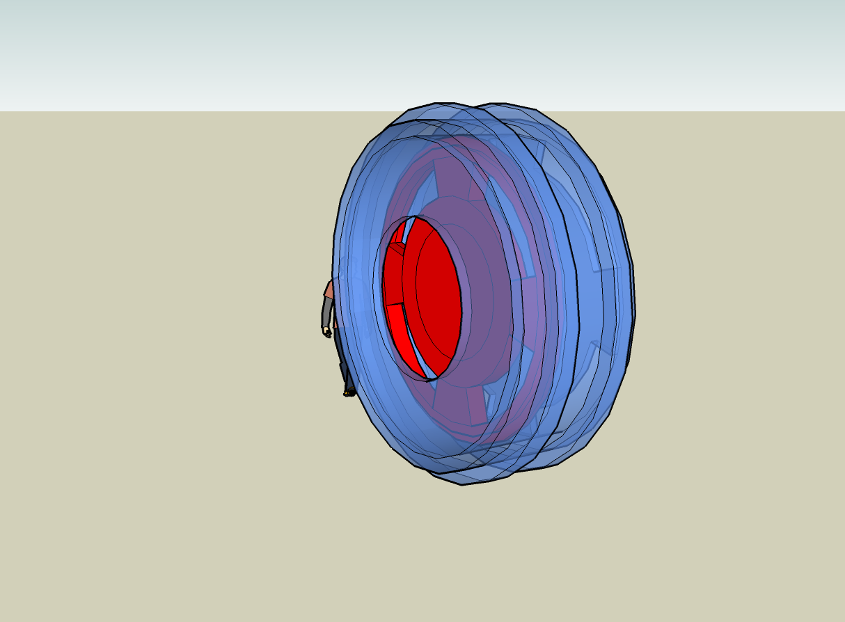

Here's a 3D model of a piston that I designed. I made it to be used with a barrel sealing or coaxial cannon. The main thing is that the equalization hole is actually a homemade check valve that has a smaller surface area on the side where air enters, giving it a possibly low cracking pressure. Its also made to be less long than most pistons, making it weigh less and move back faster.

I can't really tell what materials your model would be made of but the red portion looks like it might just be pulled out of place.

And what do you mean by it being pulled out of place? Do you mean that it be pushed out of the outside blue piece from the pressure? I never took into consideration the possibility of it being exposed to high pressures (like in copper cannons), just mid pressures to be used in nerf and paintball guns.

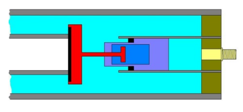

On another tangent, this had been my idea for a high efficieny piston - basically, the piston is in two parts, the purple section starts to accelerate when the pilot is opened, so that instead of starting to open gradually, the red portion sealing the barrel is yanked open suddenly when the purple part hits it. The diagram is not to scale, the purple section can afford to be a little larger in diameter.

I can see that drastically reducing pilot volume. Still kind of complicated to build, but sound in theory.

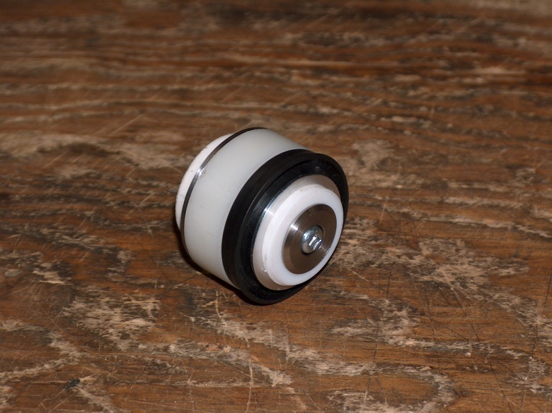

My idea of a high efficiency piston.
