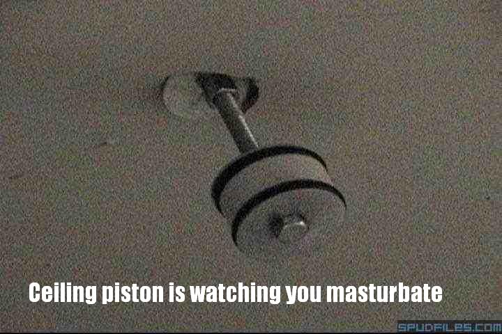

This is where the 1/2 version comes in. I kept the same tee, but I busted the slit 2" out with a screwdriver and air pressure. The air pressure was a bad idea, it sent a piston flying into the ceiling in the garage(pics below). Then I cut a shorter piece of slit 2" and reglued it in there, but this time I left about a quarter inch of 2" unsleaved on the inside of the tee. I was hoping I could use an o-ring to seal against the wall of the unslit 2". Well, this actually worked and I managed to get a perfect seal after much testing and retesting. Well why did I build another version then? Well the way I finally got it to seal involved a loose o-ring and whenever I would fire the gun it would shoot the o-ring out at very high speeds (put 2" holes in a cardboard box and dented the ceiling) No matter what I tried to glue the o-ring to it would shoot off still.

And finally here's my blooper of shooting my piston into the ceiling.
<img src="http://www.spudfiles.com/official_pics/oops.jpg">
<img src="http://www.spudfiles.com/official_pics/oops2.jpg">
