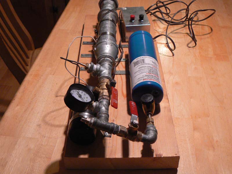

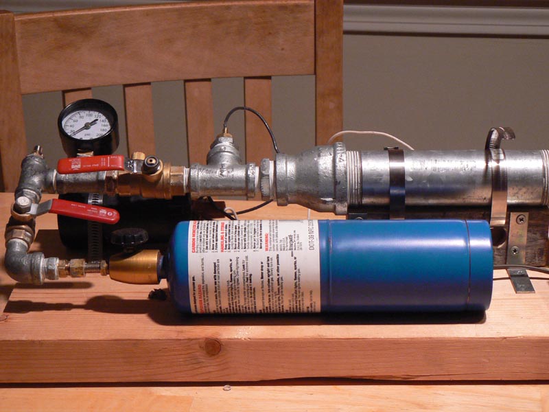

After having conquered a combustion gun and piston valve, I decided to make a hybrid both for the power and cool factor.
Without further ado, here it is...
Specs

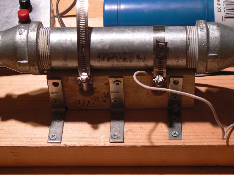

Chamber 8"x1.5" galvanized pipe
Barrel 1/2"x36"

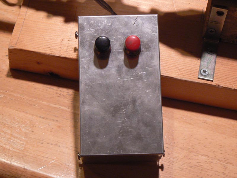

Ignition 330v Camera Flash dumped through Ignition Coil
Fuel Propane
Mixes Tested up to 4.5x, but I will go to 6x in the future
Please no comments about the barrel being to short, as this is all I have at the current time.
Although hybrids often seem intimidating, they really aren't that difficult to build. The only problems I had were making a spark plug, and getting my union to seal.
More information is with the pictures, and feel free to ask questions.

Did you get the ignition coil from a car or go cart or somthing?
Nice job on the spark plug there. I might be a little concerned about arcing through the wire insulation and into the little barb. Most typical insulation is good up to 600-1000v and good luck after that. If your spark gap in small enough the current will prefer that and you shouldn't have insulation arcing. Just be careful not to let the gap get too large. You could replace that wire with real spark plug and not have to worry about the insulation issue.

your 1/2in barrel is constricting flow like nuts, Im guessing you have a 1in union. Go but a 10ft long 1in barrel on it, that will double the energy in the projectile
And nice hybrid
