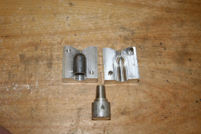

Slug came out at 830 grains. Far heavier than I wanted. Will make some changes to reduce the weight and improve the mould.( its a bugger to get the slug out, need a split mould)
Reworked my slug mold. New Foster slug comes in @ 550 grains. &amp;quot;Skirted&amp;quot; slug is 520 grain. <br />.177 swiftflite and .22 Benji dome for comparison
Reworked my slug mold. New Foster slug comes in @ 550 grains. &quot;Skirted&quot; slug is 520 grain.

New split mold. A huge improvement.
