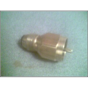

You read that correctly. Never buy a 14 oz propane tank again. Well unless you're in a dire straight and can get to your refill station. Refill, I thought it wasn't possible to refill 14 oz propane tanks. Well not until now. I found this nifty little adapter at Harbor Freight for 16 bucks that allows you to refill 14 oz propane tanks. It's really easy to do but takes about 40 minutes total to do it. You gotta take your tank and throw it in a freezer for about 15 minutes. This drops the temp inside the tank and actually pulls it into a vacuum. Take your adapter that you got and screw it to your 5lb tank first then screw your 14 oz tank to it open the valve on the 5lb and tip the tank upside down. This pulls the propane into the tank as a liquid. You will only get about a half charge before the tank warms up and pressure equalizes so you gotta freeze it again and repeat. After that you got yourself a full tank of propane. Really cool and this thing will pay for itself after about 5 or 6 refills.
Here it is  The 5lb side is left hand thread and will screw inside the OPD valve.
Propane Adapter.jpg (15.67 KiB) Viewed 5220 times
