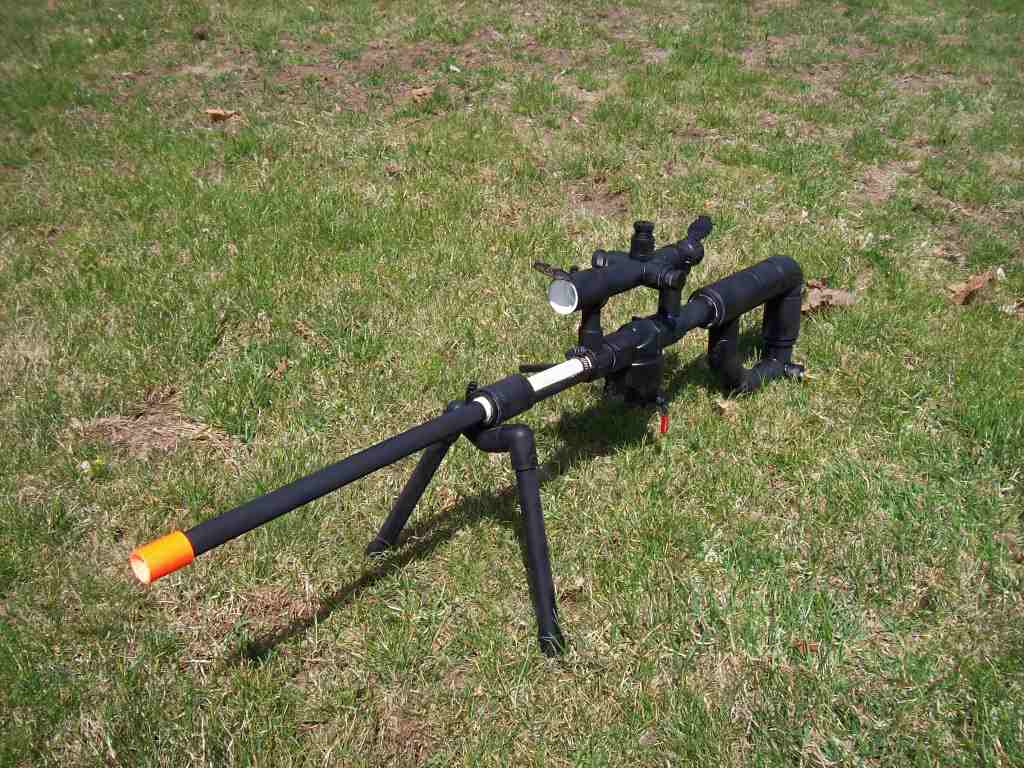

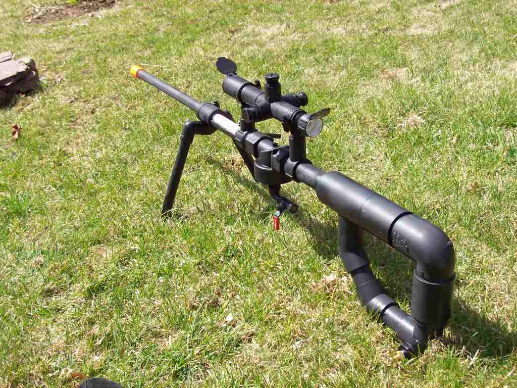

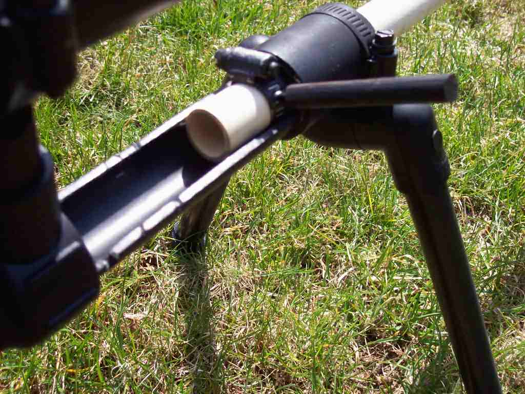

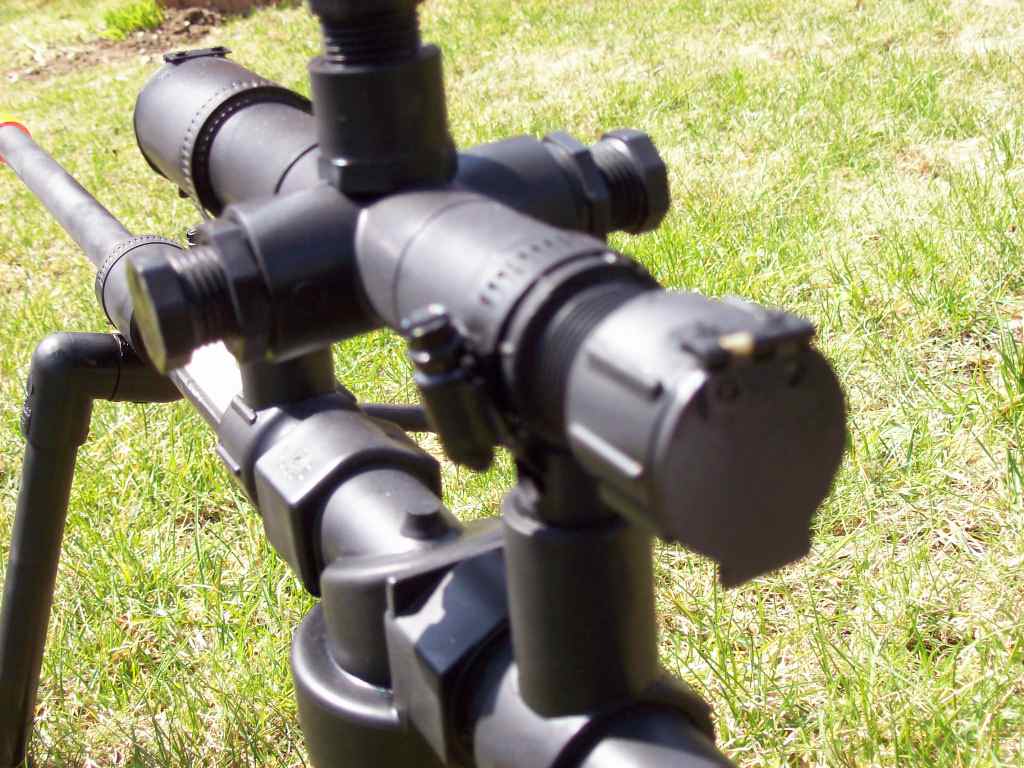

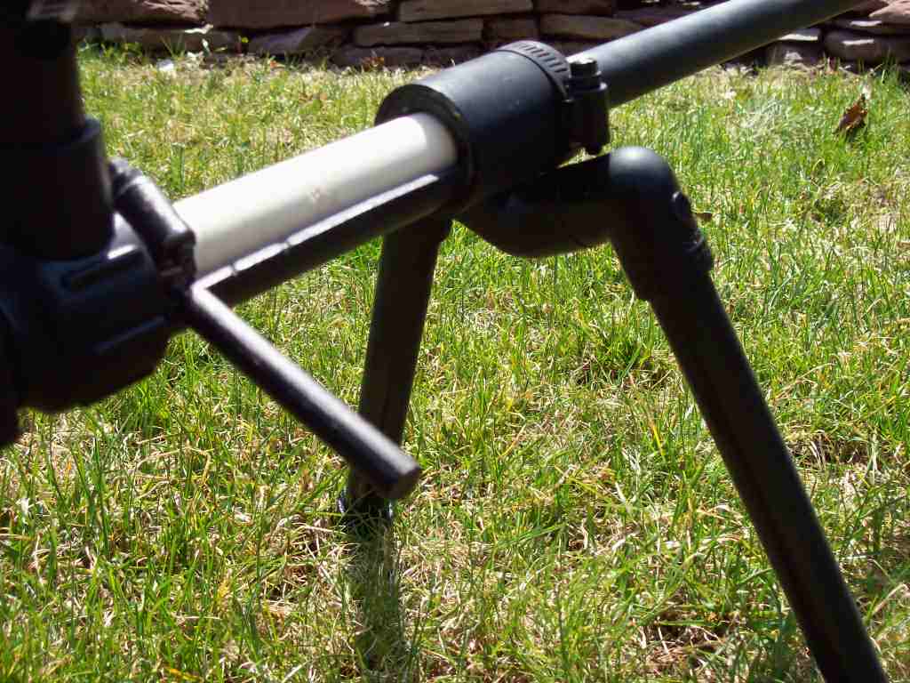

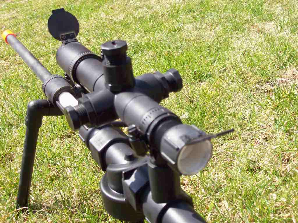

Hey, im finally finished with this gun. It works quite well and is very ergonomic. Most of it is pretty self explanitory. The schrader valve setup is all threaded- no epoxy! The stock was designed w/ safety in mind so its mostly 2 layered with both pipe and slip over it. The valve is a 1" watermaster piloted by a .25"ball valve. I like the scope, its slightly impractical, but i still do use it and it does help, it's also easily removable. The barrel is 3/4" cpvc that slides through 1" and is pressed into the neoprene washer behind it when sealed- making it breech loading (not fully my design tho.) I do get some pretty good shots out this gun. Its good with baby carrots, paintballs, or small tabasco bottles. I can also easily remove the barrel and scope and put on either a marble rifle or a 1.5" potato/ ping pong ball one. It also has a foldable bipod, and lense caps for the scope. The only improvement id like to make is to give it a .25" qev in place of the 90 deg elbow. Id still keep the ball valve, but, this would just give me a bit more oomph and much more consistent shots. ask questions if you like.
