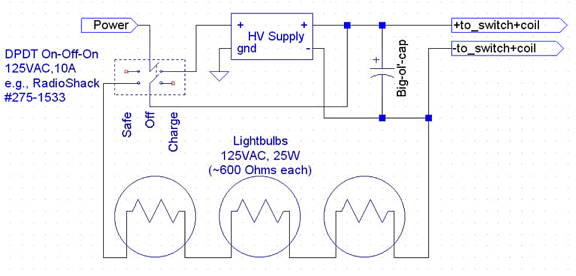

What I posted using light bulbs does (4). It'll also do (1) if you connect it when you store your circuit.

Personally, I would prefer and "on demand" safeing circuit that safes the cap(s) right now, not 20 minutes from now. Perhaps use a DPDT On-Off-On switch and a couple 25W 120VA light bulbs. Flip the switch to "charge" and the cap(s) is charged without any bleed. Flip the switch to the off (center) position and the cap is isolated from the charger and the safer circuit. (This is also handy for controlling the voltage on the cap.) Flip the switch to the "safe" position and the cap(s) are safed within a couple seconds.
Safer circuit for big-ass capictor

yes, i did mean (1). Thanks for the equations, i like your method, with the switch. I think ile do that, and see if i can get actuall resistors (more proffesional looking). For charging, i will use a MOT, so the current will be from between 200-500ma. To moniter voltage, ile use a cheap analog multimeter.
