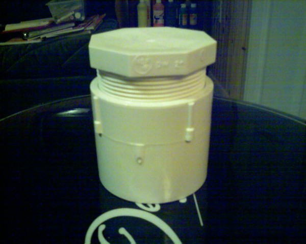

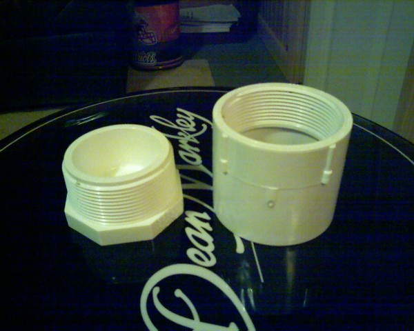

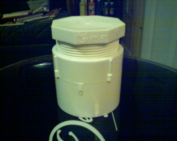

I just bought some new parts to replace the ones I broke. The first is a 2" female adapter and the second is a 2" threaded plug. Both parts indicate that they are pressure rated & schedule-40 (NSF-PW). However, when I tighten them with my hands, the two parts only thread about halfway in before they lock up. Trying to force it in any more is what broke the last set of fittings I had. Is this ok or am I supposed to use some sort of lubricant when threading the parts together? I read online something about it being bad to over-torque PVC fittings so should I just leave it how it is?MrCrowley wrote:Hmm weird, mine completely thread together.

Fittings in the US shouldn't thread all the way together. The only ones I have seen that do have gaskets on them and aren't very common or are DWV parts.
PVC manufacturers typically recommend one to two turns past hand tight, and that seems to work for me usually.

Yeah, just thought I'd add that anytime you see "NPT" thread(nation pipe thread), it means it's tapered. Like this:niglch wrote:I just bought some new parts to replace the ones I broke. The first is a 2" female adapter and the second is a 2" threaded plug. Both parts indicate that they are pressure rated & schedule-40 (NSF-PW). However, when I tighten them with my hands, the two parts only thread about halfway in before they lock up. Trying to force it in any more is what broke the last set of fittings I had. Is this ok or am I supposed to use some sort of lubricant when threading the parts together? I read online something about it being bad to over-torque PVC fittings so should I just leave it how it is?MrCrowley wrote:Hmm weird, mine completely thread together.
Thanks.
I'm not sure exactly why they taper the threads. At first I thought it might be easier to insure a leak proof fitting in case of tolerance errors in the the manufacturing process. But I work in a machine shop, and NPT threads tolerances for our parts are +-.0005 on how far the gauge threads.
Pretty much any plumbing/air supply pipe or fitting you buy in America is NPT. I guess we have to do things different from you NZ and AUS folk.
