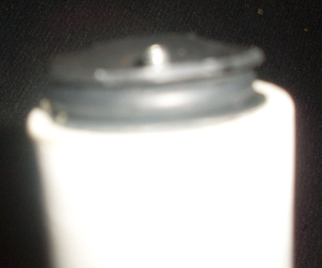

Well there was some initial teething problems, but I think I got it sorted out, the main problem that I took a while to work out was that the piston didnt have a very big washer on the sealing face so the sealing face manged to get itself folded and cut under the pressure, I put a larger washer on and some thicker neoprene and it seems to be working well now. Im still yet to go above 30PSI cos it was so loud but when I get a chance when no ones around I'll hopefully be able to get some videos at 100PSI

Piston valves do that...watto wrote:I'm still yet to go above 30PSI cos it was so loud
Perhaps even more so than any other valve, as the piston itself usually makes some noise too.

The problems I have now are; I need to find a massive washer for the piston cos the pressure keeps bending the sealing face, I put a very thin washer on that was quite big and the pressure folded it in on itself after one shot

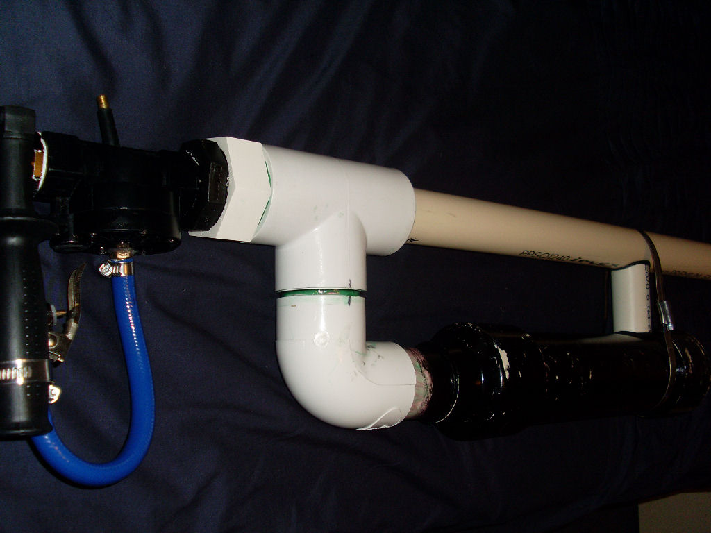

Also the sprinkler is leaking quite a bit from the exhaust side of it, maybe the hose clamps or are slowly leaking and making the diaphragm seal leak, I'm not sure, hopefully the seal is just dirty or something.
Ok heres what it looks like so far, haven't done the barrel support yet or painted
I shot it with a barrel full of water just then and it really hurt my wrists haha but fully worth it! the recoil was quite amazing, before that I shot it dry at a plastered wall and get this, the air pressure BLEW THE PAINT RIGHT OFF THE WALL!!! I don't know how thats even possible, at first I thought there must have been something in the barrel, but definately not, the wall is still completely flat with no impact marks, with the paint of about a 15cm circle of wall completely stripped off, it wasn't some half arsed dodgy brothers flakey paint job either it was a proper 2 coats done only a few years ago...looks like I'm painting tonight...
