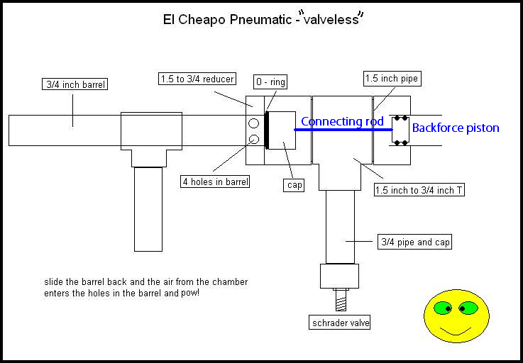

I found the patent for the above mentioned cartridge - on firing, the bolt basically hits the cartridge inner body and moves it forward, thus opening the valve against the outer body, releasing the air and firing the projectile.
psycix
Posts: 3684
Location: The Netherlands
Altough the design is nice, it is not valveless. Its basically a sort of hammer valve where the barrel IS the hammer.
Note this gun would fire if you drop it on its back end or use it to poke something. :lol:
To overcome the problem of all that pressure pushing, you could get a rod to the other side of the chamber and make an piston in some sort of extra chamber part.
Design of the backforce piston. Note that the backforce piston diameter should be a lil smaller then the barrel thing. You dont want to neutralize all force.

psycix: i think i understand your idea, would the piston have a pilot valve behind it? so that when you open the pilot the piston goes back and pulls the barrel with it? If thats how it would work, wouldn't it be more effective to just make a normal piston cannon?
The point of the "backforce piston" is to reduce the load on the valve to make it easier to open...
