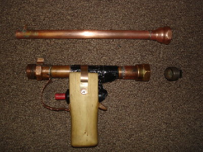

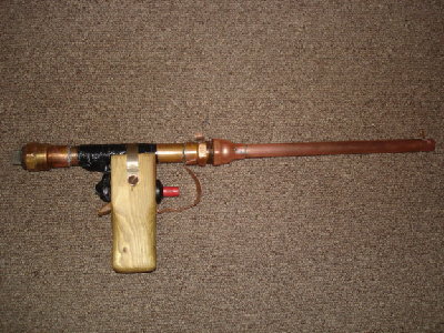

This is my first and only mini (but hopefully not last). After several months of random upgrades I decided to register to this site and post it. The mini is partially based on the mini-spud, with several differences. As you can see it has iron (copper) sights, which are actually quite accurate. I use them to hit a tin can up to about 10-15 meters away. I estimate it's range to be about 30-50 meters with propane, depending on several variables. The barrel is 50 cal. (aka 1/2 inch copper pipe) and is 10 inches in length. The combustion chamber is about 9" long and 3/4" copper pipe. It uses a BBQ ignitor and has a copper trigger gaurd and wooden handle. Any questions or comments are most welcome.

Another thing, as you can see the barrel is removable, i tried other lenghts to see how they performed, anything shorter was simply just louder and less accurate, anything much longer was almost silent but less powerful.
The pipe was all 1/2", I didn't have any pipes smaller, or a coupling for anything larger, the sizes i tried were 4", 6", 10" (current) and 16" (WAY to big lol

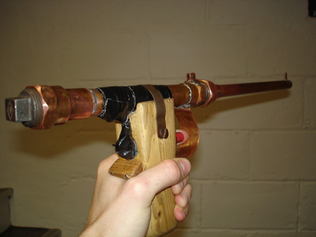

Oh yeah that's a good question 8) , I drilled a hole in the bottom of the pipe so the wire would fit exactly into it, the insulated part that is. In the beginning I had some major leakage problem, i eventually fixed that by hot gluing the base of the wire and then wrapping that tightly with the black electrical tape you see. Another wire is just taped to the side, so the spark jumps from the wire inside to the wall of the pipe, it's very reliable unless the wire somehow gets bent.
Interestingly enough i can only get it to shock me if i touch the wire directly or the sparker...which is hard to do, and if i were getting shocked, believe me, i'd know it, even with a BBQ ignitor i jerk me hand back pretty fast if it does shock me, lol.
