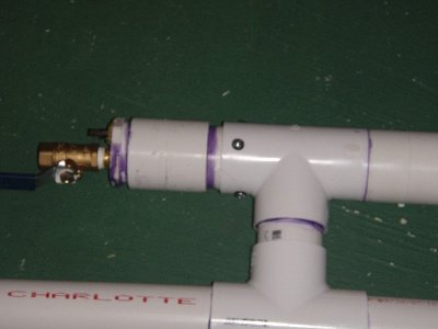

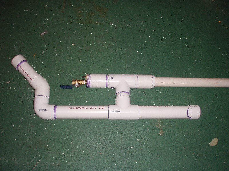

Here is my cannon built from MrCrowely's howto with a different chamber shape. I have tried three different pistons, everyone of them holding the pressure, just not activating.

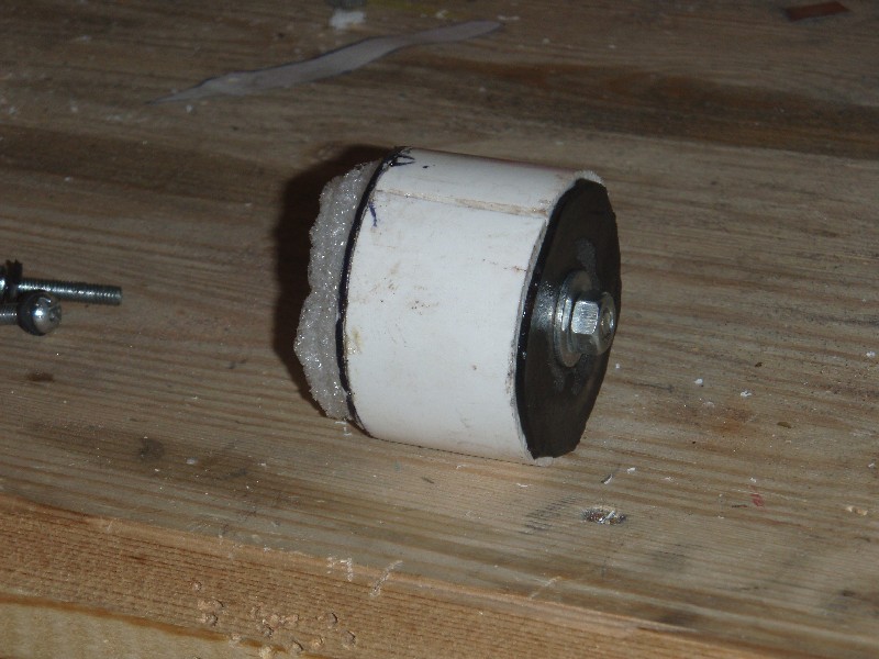

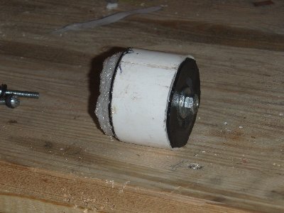

The piston fits snug, but not tight(its easy to move) and I followed everything I could find with the search button (which I have found isn't that great).

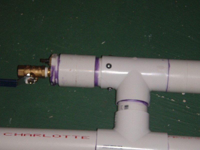

Could the pilot volume be too big? The store at the time didn't have any 2" endcaps so I had to use a coupling and a slip plug. The cement hardened too quickly (noob mistake) and I couldn't push it all the way down so i was left with a huge pilot volume....
Please tell if I did anything obviously wrong.
Please don't tell me to use the search button, I've been trying to find the answer to this with that the whole friggin day...
My Cannon so far...
This is a good effort here. Chances are the piston is letting too much air slip around it...I battled the same problem. You should be able to pull the piston in and out and feel a little air vacuum resisting it.
I ended up using multiple coats of white plastic paint to get the diameter of my piston up to near perfect fit. It will take some patience because you'll want each coat to dry fairly well. I think I remember 10-12 coats for mine.
Thanks for the replies, it is really snug, if I try and blow through the barrel I can push the piston out with my breath easily. I may try a few coats of paint to see if that helps...

For the pilot volume get a knee board made from foam. They are usually sold in a garden centre, they are for kneeling on when gardening so you don't get sore knees. They're quite thick, about an inch.
Cut some circles out of it that will fit in the back of the piston housing, then cut about an inch wide hole in the middle of each disk. Not only will this act as a bumper but it will eat up most of your pilot volume.
Pilot volume would be a factor but with a pilot valve of that size you still should get some results. You can always put an end cap on later since it's bolted.
The only other thing I can think of is that your piston might need some lube, not to help with friction but to help a bit with sealing against the sides of the piston housing. It can create a vacuum, as Starman said, better.
Also that groove in your piston from where you joined the PVC to make the piston body could be letting air go through it.
I'd just get some bondo and put a small strip of it down the groove and then wait for it to dry then sand off the excess.

Damn, I would say it was a combination of what people have said, and your pilot valve. Looks like a .5 inch ball, I think a 1 inch sprinkler would be more adequate.
Yeah, thats it, big pilot volume small pilot valve.
Well, I couldn't get it working, it seals fine but it still won't actuate. I lubed it and when i push it down I can feel the air pressure holding it back. I also 1/2" thick 2" diameter plywood discs with holes drilled in the middle of them to reduce the pilot volume.
