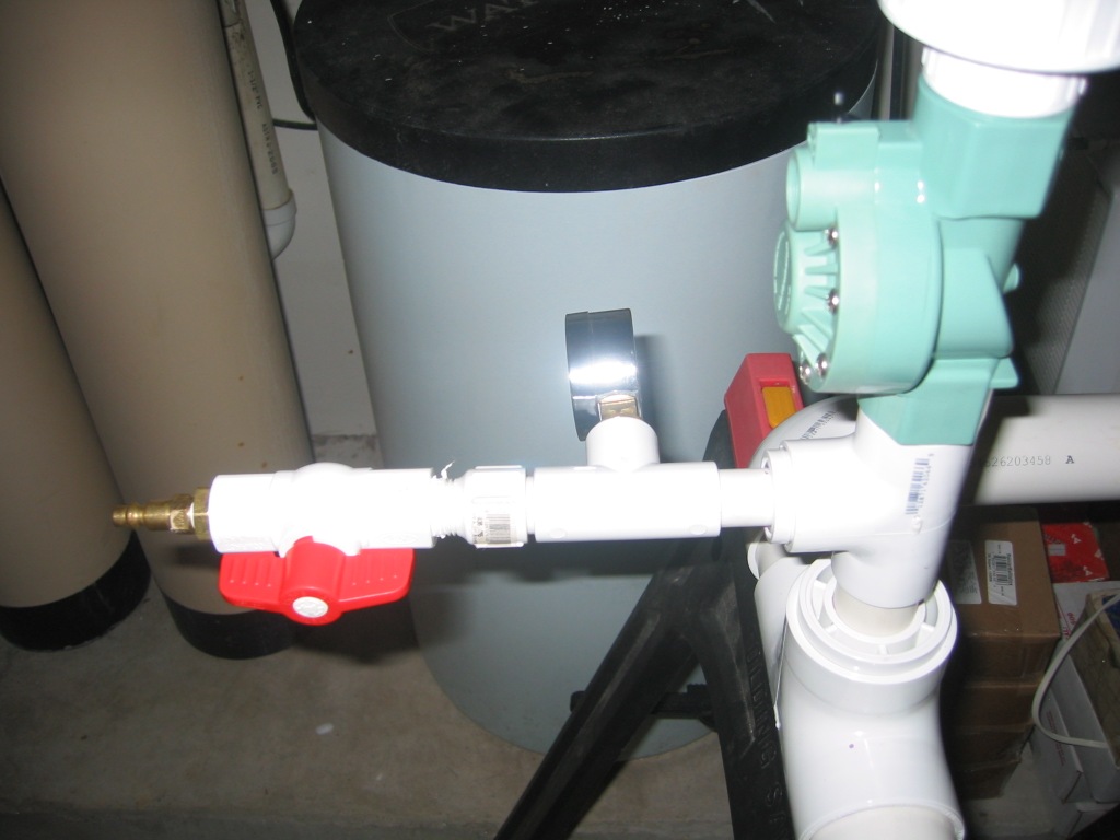

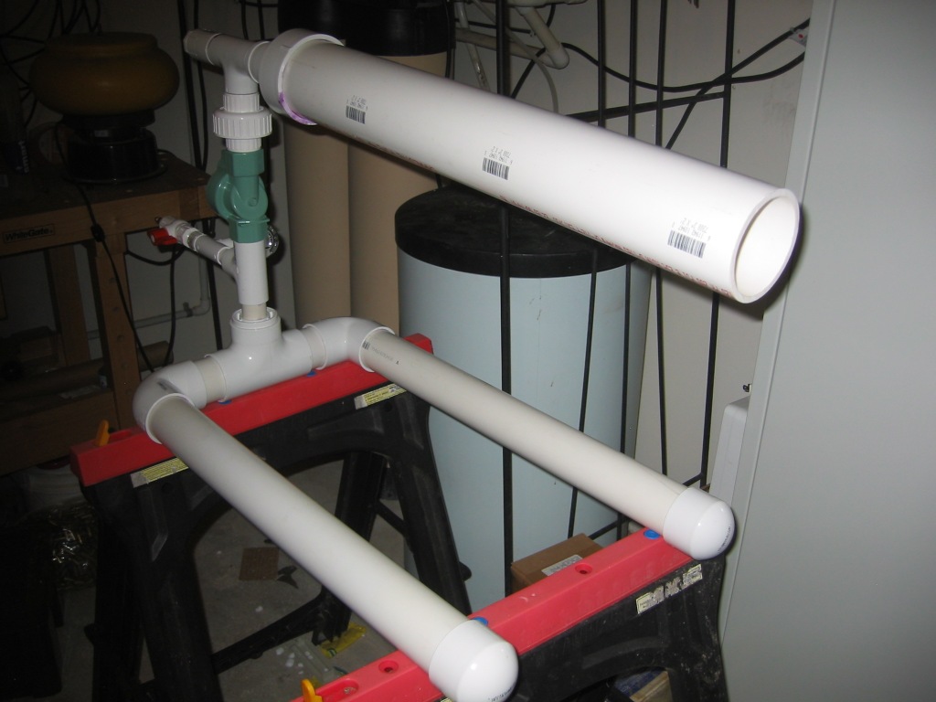

Nice work, but, scrap the bell reducer. Replace with a bushing / coupling combo.
THUNDERLORD
- Posts: 1264
Nice post.
A barrel support would definately be a good idea.
The recoil puts stress on the connections ( The barrel flex can be seen in the vid).
I wouldn't want to use it without a barrel support.
Or with the bell reducer (already mentioned).
Other than that looks like a nice test platform for various stuff. 8)

I agree with you that the bell reducer in this application will be under much less stress...but...
You are using your sprinkler valve as the sole structural support between the chambers and barrel. The design also makes any proper barrel support fairly large, but something you should add on there soon to take the stress off of your 1 1/4" feeder and sprinker.
It's little gangly looking but you're generally getting the job done there. When do you plan to shoot a real airburst?
Good job with the detailed post!

Nice, and interesting design, im curious though, do you have canaries? I can hear them in the background pretty well.
Back on topic, i would have chosen a different design, only because of the stress on the valve and the fittings, but its ok and looks fun and portable.

Sorry I just have to quote you on thatBell reducer DWV blah blah blah, doesn't really matter in this cannon
dwv is not blah blah blah, it is serious. All your cannons are an extreme danger to operate and I wouldnt want to be anywhere near it when you were charging one up or firing.
I know that it is under pressure for only a short amount of time but that doesnt mean it wont go boom or fly off, esspecially with the heavy ammo you are using. But in your other cannon the dwv is under a constant pressure which is VERY dangerous.
You assume that it is fine because it hasnt gone boom on you yet, but its only a matter of time before it does.

C'mon, give the guy a break. If you actually took the time to notice that the bell reducer is on the BARREL, then you'd know that it's not important. Okay, so if hey uses some ungodly high pressure in the cannon, (which he doesn't) then his barrel might blow off. OH NO! (Big deal, I know) Before you guys jump on him for using DWV, you could at least give him props on what a nice launcher he built. [/rant]
Anywho...
Nice job man. You seem to be a very promising upcoming member and i hope to see more from you in the future. But as bigbob was saying, just be careful not to use any non-pressure rated parts on your future chambers. For barrels, DWV=OK.
Anywho...
