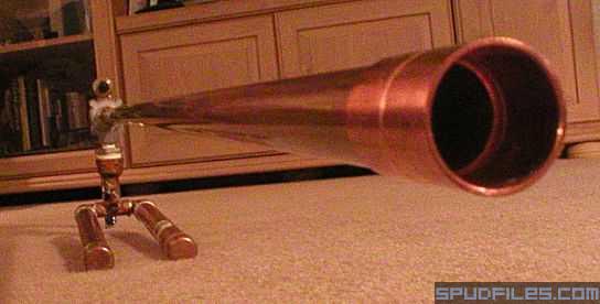

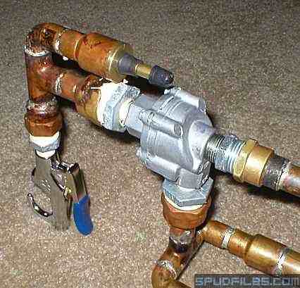

In this picture you can see the rear of the gun, where most of the 'action' goes on (Second only to the barrel) In the middle you see the QEV, it has 1/4 in and out ports, and a 3/8 exhaust. It is cast aluminium and ordered directly from McMaster. Since t

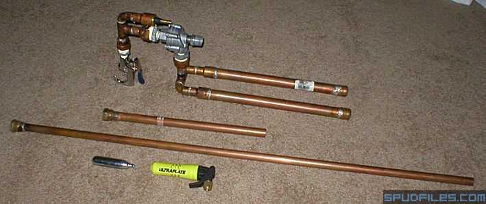

As of right now I have 2 barrels for the CDAC. One barrel is just shy of 3' and made of .5&amp;quot; copper pipe. This is the main barrel I use and is incredibly accurate as well as powerful. For ammunition, I have made some of my own lead slugs but theyre a
As of right now I have 2 barrels for the CDAC. One barrel is just shy of 3' and made of .5&quot; copper pipe. This is the main barrel I use and is incredibly accurate as well as powerful. For ammunition, I have made some of my own lead slugs but theyre a

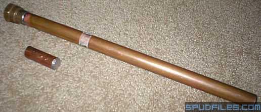

The other barrel is simply a .5&amp;quot; long coupling. If you dont know what a long coupling is, imagine taking a .5&amp;quot; pipe coupling ans stretching it out to a length of 12&amp;quot;. This barrel is used for shooting special ammunition I make myself.
The other barrel is simply a .5&quot; long coupling. If you dont know what a long coupling is, imagine taking a .5&quot; pipe coupling ans stretching it out to a length of 12&quot;. This barrel is used for shooting special ammunition I make myself.
The ammo is simply a length of .5&amp;quot; pipe, filled with lead. Unfortunately since this barrel is so short, it is horribly innacurate and doesnt bring the ammo up to full speed. <br /> <br />Since I only resently finished the gun I havent been able to get many dam
The ammo is simply a length of .5&quot; pipe, filled with lead. Unfortunately since this barrel is so short, it is horribly innacurate and doesnt bring the ammo up to full speed.

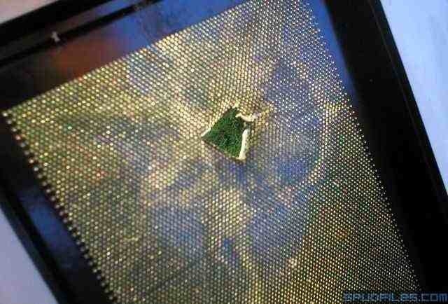

CDAC Vs. My old microwave's door. <br />This was the first shot I made with the CDAC. I used a small lead slug (.75&amp;quot; long) so shoot right through the door of the old microwave. In case you didnt know a microwave door has about 3 layers of lexan and a 1/8&amp;
This was the first shot I made with the CDAC. I used a small lead slug (.75&quot; long) so shoot right through the door of the old microwave. In case you didnt know a microwave door has about 3 layers of lexan and a 1/8&
CDAC Vs. My old microwave. <br /><br />This shot was made from approximately 10 ft. away, using a AA battery. The Microwave was lying on its front, so I was shooting thru the top. As you can see it EASILY penetrated the 2 layers of sheet metal on the top, traveled

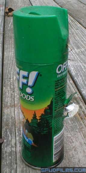

CDAC Vs. OFF! Deep Woods can. <br /><br />I really enjoyed this shot. I set the can on a brick 20 feet out into my yard, I laid down and 'sniped' it with the AA battery used to shoot the microwave. The can was almost completly de-pressurized before I shot it. Unfor

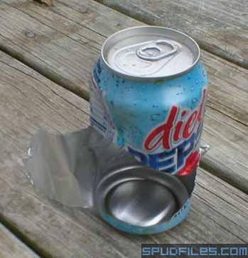

CDAC Vs. Diet Pepsi can. <br /><br />You can't really tell from the picture but this was an awesome shot! Another 'sniper' job, I got it from about 10 feet back. I hate diet pepsi so much I just couldnt resist! To really appreciate this you need to see the video, i

What kind of valve r u using EXACTLY? can u give the page u got it from?
spudshot
Posts: 1036
its a 3/8" deltrol QEV from http://www.mcmaster.com

i really want to build 1 of those but i cant find the valve on mcmaster!!!!! :shock: :shock: could someone tell me what category its under or what page its on

kk thx i got my valve in the mail today and i have all my supplies. i think im going to build it with 1 long chamber instead of 2 also do u use 12 gram co2 to fill it and if so what pressure does it go to

i'm wondering how much pressure a 28mm of diameter copper pipe can handle? Cuz i actually have a soda bottle with glued diaphragm valve, and i put it to 60-70 psi, even at these pressures, recoil is substantial and with water, it breaks you the arm!! so how much pressure can 2mm thick copper handle?
drac
Posts: 899
Location: Avon, NY
500 PSI is a rough guess. Even though, I wouldn't take it above 250 if neccessary.
boilingleadbath
Posts: 1635
Location: Pennsylvania, USA
True, the copper may be capable of taking 500 PSI. However, I don't think the valves are rated that high... 250 is pushing it, but shouldn't cause it to fail - most ratings have saftey margins in them.
