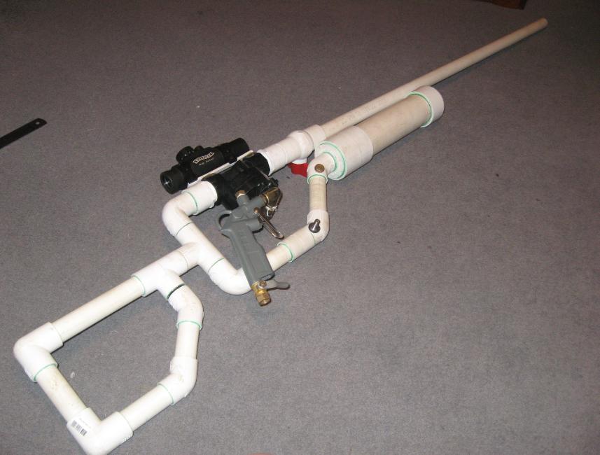

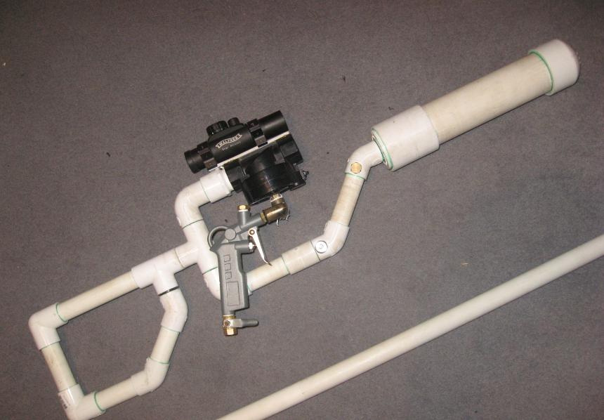

I've finaly decided to add those finishing touches to my marble gun.
Now my barrel is curently copper sleeved in 3/4" PVC and fits marbles perfect, but its 90cm Long.
My chamber is 2" Pressure PVC (its an under over config, ill dig up a link with a pic later) and its 30cm long.
I want to shorter the barrel and get more power but keep accuracy.
More power = Bigger air chamer (Cant exceed 120PSI)
Accuracy = Longer barrel (Ill have to sacrafice accuracy)
So what im asking is, what would you do if you wanted it to be more close combat like?
Ill edit a link in soon.

Hey,
I cant upgrade to metal, it will remain Pressure PVC.
Im using a sprinkler valve, actuated by a blow gun.
I'd say my barel is excellent, marbles fit with about 1mm gap.
Ok pics are up.
I Think im going to keep the chamber the same size but maybe decrease barrel length to... hmmm lets say 50-60cm
what do you all think?
Btw this is jst a rebuild. I'm attaching a new scope, going to go for the open holographic red dot sight, a gun sling, proper spring loaded bipod and a paint job.
