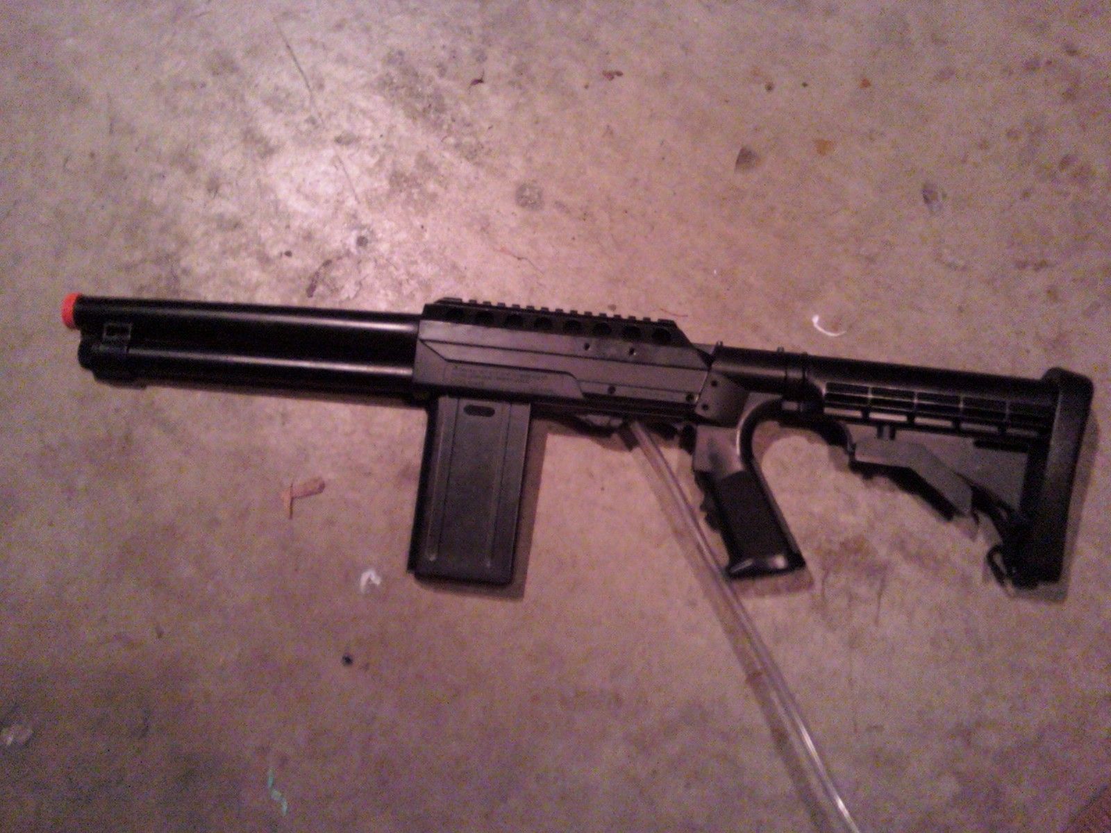

This is based of davidvaini's prototype magazine fed bbmg. I'm very impressed with it.
A shot with the gun opened up.
This is the heart of the gun. Basically a 6 mm tee with a hop up inside it.
How it looks holding it. Yes it's drooping the screws aren't in.
The whole thing. The hose is only temporary until I get myself a c02 inflater.
The shell was a utg 870 spring shotgun. I found everything I needed except for the hose and epoxy in it. :D
The magazine holds 30 rounds and empties itself in less than a second. So an estimate on rounds per minute is 1800.:shock:
The damage pictures will come tomorrow with some other things like effective distance and some better pictures. If you want a picture of something or want to know something just ask.
Sorry for the bad pictures they were taken on a phone then sent to my email.

Nice, but where is the magazine, and where is the firing valve(blowgun I assume)? Apart from that When you get the screws and such in, can we get more pics? Because I want to see it when the barrel is not drooping.

Yeah I'll get some more pictures in the morning. Along with some video. Can't believe I forgot to put the magazine in. :oops:
*facepalmdeskslapcombo*
Yeah the blowgun is on the end of the hose. The hose will be chopped to fit inside the gun when I get the c02 inflater.

Thanks, the gun is sagging in the pictures but I should have some new ones up later today along with some damage pictures and maybe a video. I'll be using my phone so the video quality will be crap. I plan on giving it a nice paintjob of blue tiger camo. Think call of duty 4.:)
on yours the air isn't "pop corning" the bbs at all. If you can move the air line to the bottom it should increase your rate of fire and air efficiency. Oh and your using a magazine not a clip.

Sorry for the long wait I've been busy and haven't checked my email in a while. I plan on getting a co2 inflater for Christmas. I'll have to hack the whole handle to make room for it.
In the picture where the pump action is supposed to go I might make a bolt action/breech loading grenade launcher, probably based off your idea :roll: . I'm very impressed with this design.
I showed it to some friends I airsoft with and they were amazed.I'll have to pick up some extra magazines though. Right now I have a 30 round and a hi-cap for it.It can spit out about 30 rps. I'm thinking about making one of those automatic winders for the hi-cap. I can pm you after Christmas break when most of these updates happen so you don't have to keep checking.
EDIT- Does anyone know of a nice co2 inflater that works with unthreaded 12 grams and has a trigger?

Yeah the part that looks like like a tee the bottom port is for the magazines. I just realized none of those pictures have the magazine attached so I'll take some more pictures.

The only downside is the shear rpm of this. It's a real pain to have to keep winding the hi-cap. But its perfect for the situations like theirs a sniper over there but I don't see him. One second pull of the trigger and you get 30 rounds downrange with a couple feet grouping and the sniper dead.
Here is a picture with the magazine inside the gun.
