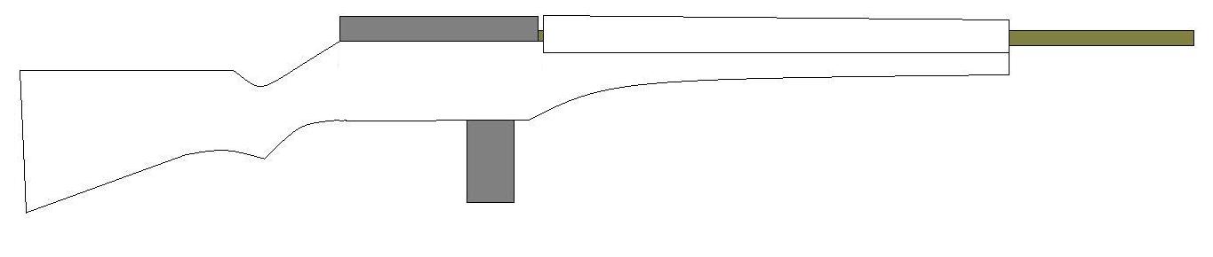

All the plans only exist on paper, I decided on paper so that I could do the curves of the stock easier. The only plans that I could potentially post is a sort of template for the 3 piece stock, which would not be much good without the actual design of the firing mechanism, which is really nothing special, just imagine 5 inches of 1 1/2 inch horizontal ABS connected to a T piece , connected to a vertical piece about 6-7 inches long (taking the place of the magazine) then at the other horizontal portion of the T piece, a 1/2 inch barrel, which would be covered by the barrel guard on the actual m14, I am going to do a rough paint layout tonight, and maybe provide more details tomorow.

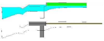

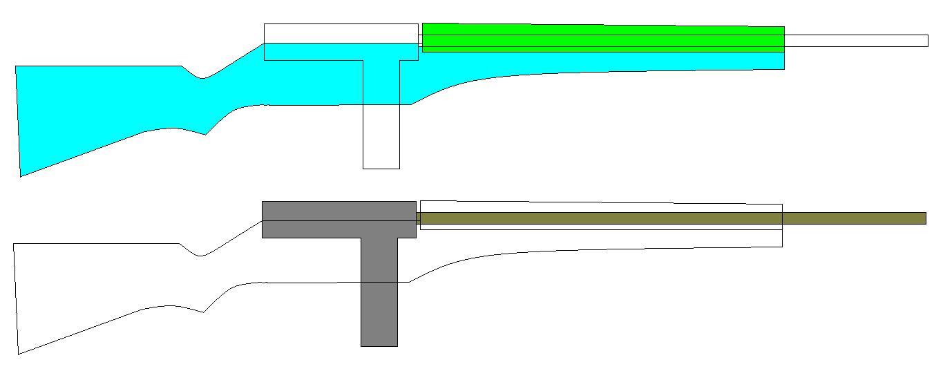

Here is a simple layout, remember that all pieces of the stock are made up of 3 pieces. The top diagram shows the 2 separate stock partitions, and the bottom shows the pipe layout more clearly.
The last picture is just how the stock will look and cover the pipe.
Stock overview
Stock overview
m14 2.jpg (18.08 KiB) Viewed 1045 times
Cross sections (kindof...)
