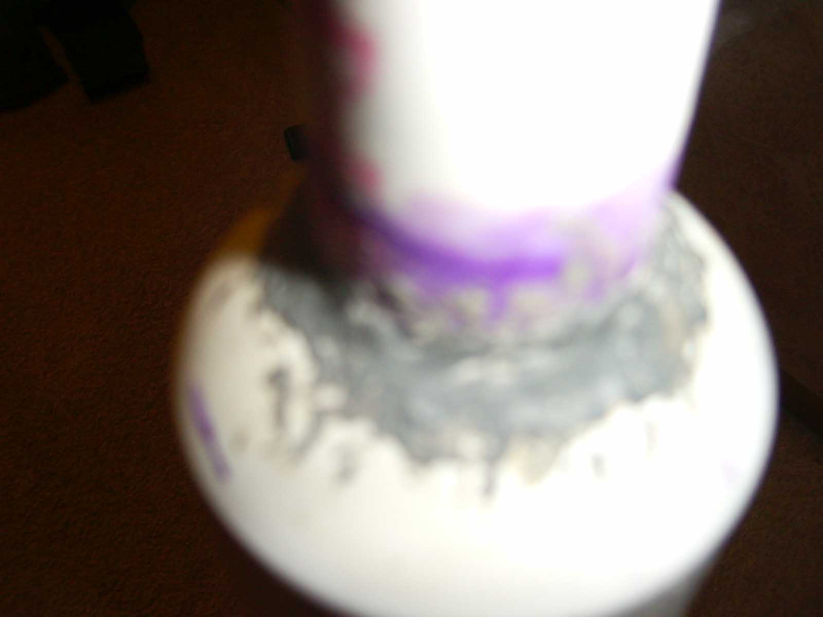

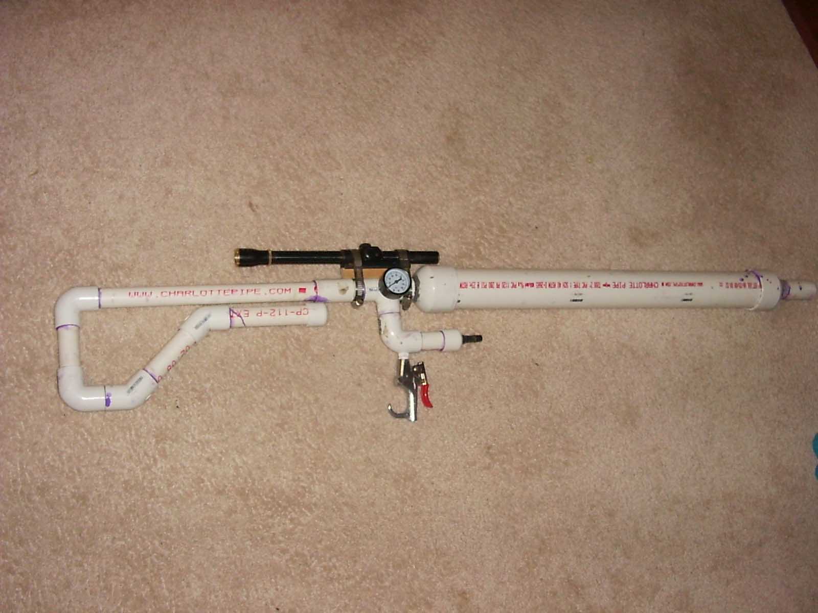

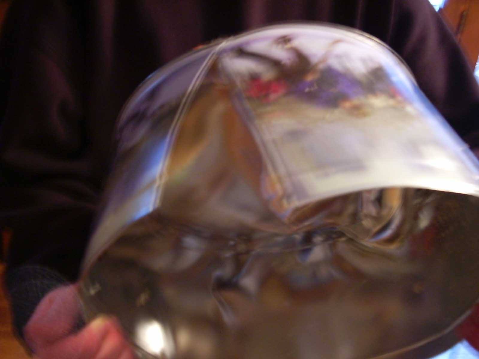

Hello I built the below cannon recently, and was not planning to unvail it until it was 100% finished, but I have come for help. the problem I a having is that I keep developing a leak between the end of the barrel and the end cap. I first used solvent glue to bond it, but it started to leak. Than I put a generous layer of JB weld on and then it did not leak for about 5 shots. after that I lightly snaded down that layer of weld and added a second over top of that. After 10 shots the leak came back. Please help me! I will also include a damage photo. the tin was only shot once from about 10-20 ft away, with a 1" potato slug (this was before I found the BB gun scope in my basement) it is very powerful using a Diaphram valve with an opening distance of 1/4 inch (at least that is what it is when not under pressure!)

jb weld IS epoxy.FishBoy wrote:I would get rid of most of the jb weld, and put some epoxy on it, it tends to do a better job of getting in to the little cracks, etc. that cause leaks. Plus the jb weld is ugly.
I let it cure for 2 days, just incase. I would clean the JB weld up with sand paper before I paint. this is raw still. any other suggestions would be nice

I'd suggest scrapping the jerried-up end caps and using some bushings in there instead. Use a Dremel or file to grind out the lip that keeps the pipe from sliding through.

If that is an end cap(which it looks like one) cut it of get a reducer bushing(looks like it is 2" to 1") and put the barrel in that. Then it won't leak.
I say scrape away the jb weld. Then make sure it is clean and sandpaper the whole area to roughen it up. Then go to a store that sells epoxy and look for some epoxy that says it works with plastic. Most epoxy states on the package what type of materiels it bonds with.
Basically try again, but with a different type of epoxy. I have found that JB weld doesnt do so well with pvc, but maybe that is just me.
Very true, I should have been more clear. Get some sort of marine or other typical expoxy, many stores sell 5-min epoxy in small double-syringes for cheap. The idea is that JB weld doesn't flow very well, so it wont get down into the small hole and seal it up, that's the problem.frankrede wrote:jb weld IS epoxy.FishBoy wrote:I would get rid of most of the jb weld, and put some epoxy on it, it tends to do a better job of getting in to the little cracks, etc. that cause leaks. Plus the jb weld is ugly.

Thanks for all the suggestions. I will try and use some plastic epoxy, and if that dosen't due the trick I will use a bushing
