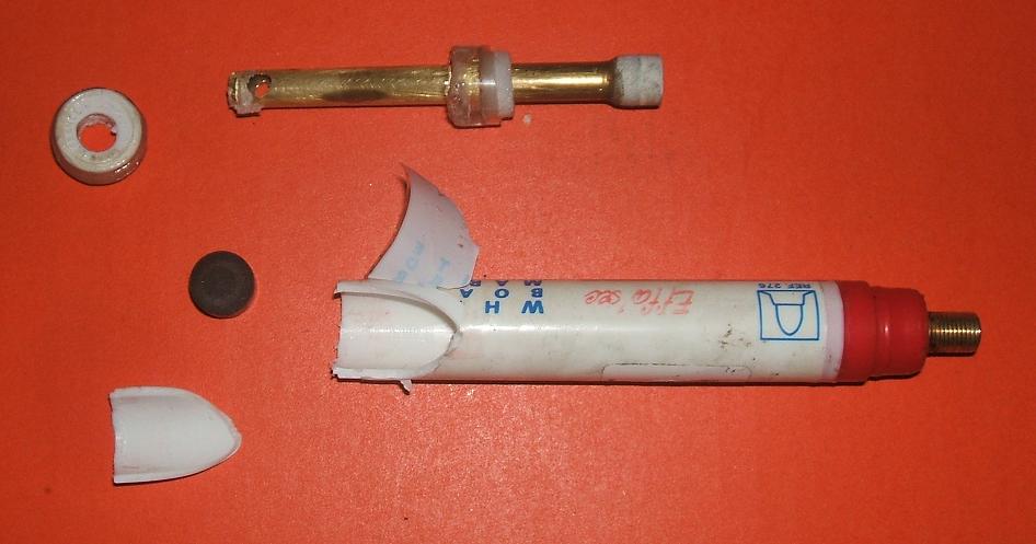

I tried it out at 200 psi and it was working beautifully, so I thought I'd give it a go at 400 and well, it blew up. Mea culpa for not using a pressure rated marker!
Recovered parts :-/
Recovered parts :-/
Detail of the muzzle bent out of shape after impacting with the wall at considerable velocity, luckily it wasn't pointing at me at the time!

What gave you the idea that a plastic marker pen tube could handle 400 psi? It is plastic, right? Looks like it. I'm just wondering. :shock:
jrrdw wrote:What gave you the idea that a plastic marker pen tube could handle 400 psi? It is plastic, right? Looks like it. I'm just wondering. :shock:
Well, I figured the fact that it was syringe tube-epoxy layer-marker body it would be enough. In fact, interesting to note that it didn't explode outwards but the barrel flew out of the front, hence the broke section of marker. I'm thinking that if I had roughened the inside of the marker body it could have held.
I might give it another go, but if I do, metal body this time :roll:
What?!
YOU forgot to roughen up the inside before casting epoxy?
That was the original plan, but the smallest practical tubing I had available was fractionally bigger than the marker interior so I went for this option.
Well, besides looking for small diameter pipe, you could also have looked for metal markers or pens. Or maybe some other kind of tube-like stuff some examples: hull of a laser pen, mini flashlight or maybe a bullet casing. Basically anything thats metal, cylindrical, hollow and on the right size should do the job better then a syringe tube.
You can also reinforce the plugs by making small holes and put bolts (or on this size, needles) through the pipe wall. Maybe denting/bulging the metal inwards would also do it.

Though i'd give it another go, but using a metal tube for the chamber and sleeving it inside the marker. :)

I would say screw the marker tube and just make it the size of a marker but this is pretty cool. just make sure you roughen the surfaces.

Have you considered a wrap or two of glass cloth around the chamber?
Perhaps cast some lugs into the ends through the tube wall to lessen the chance of their departure.
