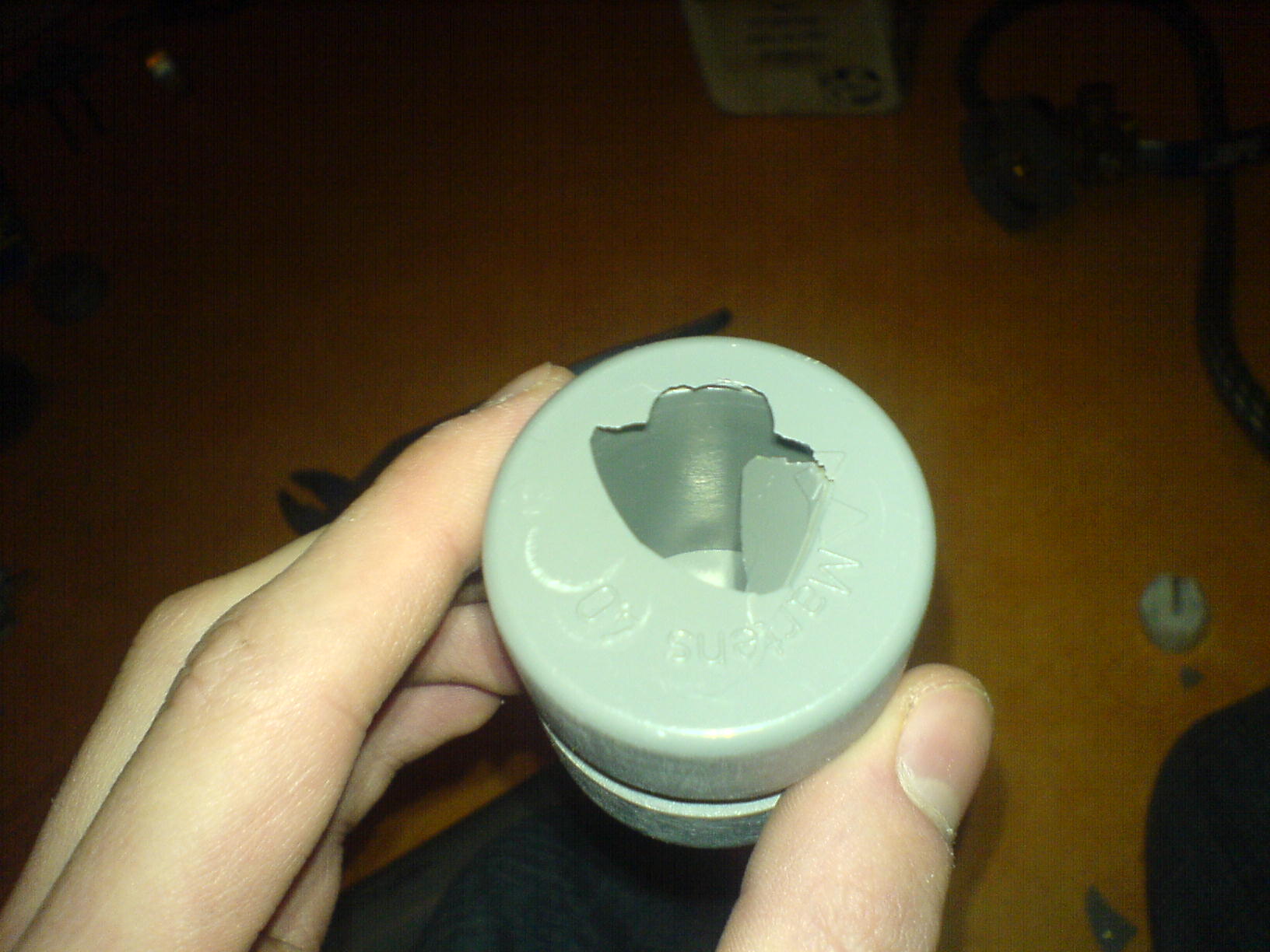

The only fail was that I fired it without a bumper for the first time when I tested whether it would seal. The piston endcap broke. Luckily I didn't glue the piston yet.

The piston before it was glued, after the first shot before I installed the bumper.<br />I replaced the broken endcap and installed a bumper.

That broken endcap must have been exciting :?

JSR wrote:That broken endcap must have been exciting
I mean that I was exited that the gun was almost done so I tested it to see if it would seal and the fired a blank shot. I was even more exited as the valve sealed and pilotted just as it should. Discovering a broken endcap was a bit "WTF".
I figured that it wouldnt break on only 1.5 bar.
