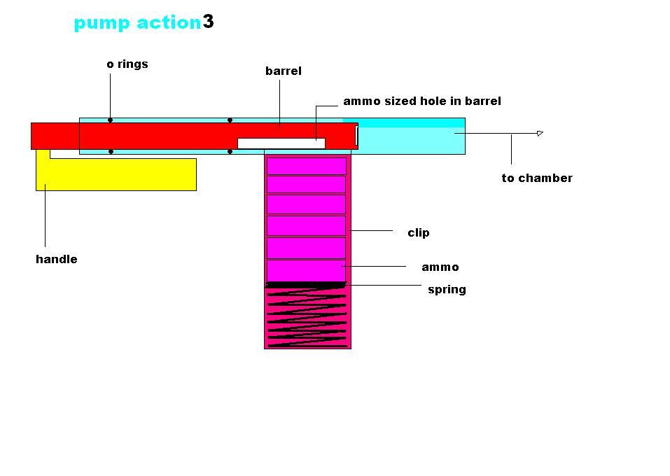

new pump action.
)DEMON(
Sergeant 4
Sergeant 4
Posts: 1391
Like always this is simple, so I will leave you to figure this out yourselves, unless you ask me to explain it.

i see one problem. pressure from the chamber can enter into the clip. somehow i donnt thing that clip can hold to much psi. have the barrel come back farther into the chamber and put another o-ring in it before the clip.

It is a rough idea,if you want to use it then you make your own changes, I see what you mean, simple fix.

actually thats really good, idea.

wont you lose a hell of alot of pressure, from the hole for the ammo?

It wouldn't be an issue and you could always make the magazine air tight (with and o-ring).
