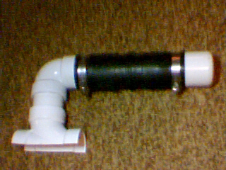

stud zooka is a pnuematic launcher that i made to launch heavier and more akward objects.
stud zooka has a 3" barrel for baseballs, t-shirts, and sodabottles & a 4"
barrel for toilet paper and softballs.
this gun is triggered by a 1" rainbird cp-100 and comes with cam lever couplings so i can easily attach and remove barrels.
the launcher is truly a stud. it's power is devastating at close range.
This is STUD-ZOOKA Enjoy!!!
this is the handle i plan to strap to the chamber for easier carrying.
stud-zooka's chamber
this is a Mt. Dew bottle that got smashed on the front end so hard it looked like water blew out the back!!! (see how it ripped thru the whole bottle?)

Damn fine! Although your camera sucks.
So clean! Like how everything is setup. Thats quite alot of air to push threw one sprinkler... At any rate, nice job. I usally dont reply to nice cannons that dont break the mold as concepts go, because you cant really say anything, but nice! To tell you the truth I would never thought you could construct such a nice cannon.

Why did you put this mega luncher sised chamber realy?I don't know about diafragm valves but if you are able to get more then 1 shot with that chamber, wich is inposible with a ball valve.

The large chamber was necessary so that I could use a large barrel to launch large objects. :roll:
I think you mean "why have a large 4" chamber with only a 1" to fire it".
I was a bit sceptical myself, but it really does fire hard & well.
Maybe it looks larger because it's an inline...
How do I put pictures in the quick replies? I want to show my proof.
noname
Posts: 2698
Location: Bay Area, CA
The only way I've seen is to edit your post and then do the pictures. And yeah, a 1" sprinkler is kind of small for a 4" chamber and barrel.

Oh my goodness! i added a little wadding around my soda bottles today and holy cow what a difference!!!
adds an extra 50 yards to every shot plus it kicks pretty hard too!
wasn't holding on tight enough the first time i added wadding and it smacked my arm pretty hard!
this is getting interesting...
And yes i think the valve is a bit too small but i'm really starting to think it's not harming the performance that much.
would a homemade valve perform better? cause if it could i'd use the sprinkler for a later project maybe.

Try making a valve in a 3" T or something big. That would increase your performance a ton. If you want it to be really good you can use the sprinkler to actuate the 3" homemade. It makes it open extremely fast and dump TONS of air.

Ok i just posted some power proof @ the top so enjoy.
would a 3" tee really be that powerful if it ony had 1" openings?
cuz that's what this gun would have.
but i don't think i need to change anything, this gun was a satisfying success and i was more than pleased with the results.
