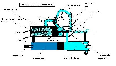

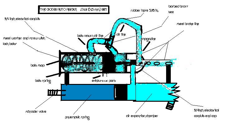

ok so here's the refined version that i (crudely) put together, i took jsr's idea for a valve to pulse the air inlet and it ran like a sewing machine for about 5 seconds, then my epoxy let go and the valve exploded across the room
Don't tell jsr but i may have to stop using that stuff
i plan to put it back together with jb weld and give it a go, i might even load it this time
How long did you let your epoxy sit ?
Did you roughen up the surface and bit deep grooves in it ?
Those are the two main factors that cause Epoxy to fail
Note epoxy cure time very important barrels are hard to remove from the wall
Or rather, you may have to start using proper stuff properlysuture self wrote:the refined version that i (crudely) put together
