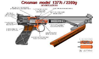

here is my partial design, what do you think?

A few items that pop to mind;
You will need some way to hold the piston closed once you compress the air in the chamber.
A sprinkler valve has a (comparatively) large volume on the downstream side. In combination with what looks to be a fairly small chamber charged to low pressure, this will substantially lower the pressure available to accelerate any projectile.
Low pressure in combination with a small bore size will fail to impress power wise.
I would recommend replacing the sprinkler with a blowgun, small piston valve or 1/4" qev.
This would remove most of the valve associated dead space, and improve performance, while still keeping it simple.

A check valve should do the trickGippeto wrote:You will need some way to hold the piston closed once you compress the air in the chamber.
Not to mention it probably won't seal with such a low flow.A sprinkler valve has a (comparatively) large volume on the downstream side. In combination with what looks to be a fairly small chamber charged to low pressure, this will substantially lower the pressure available to accelerate any projectile.
Agreed 100%, for small calibres a blowgun is great, with this setup at just 100 psi I can do thisI would recommend replacing the sprinkler with a blowgun, small piston valve or 1/4" qev.

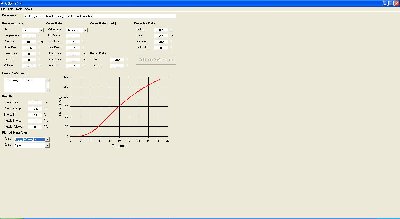

@ Carlman. Really? I've seen some videos of these that got shot through one side of a steel can at 100 psi. Actually, the barrel is going to be about 29" long. I'm still thinking of using a 3/8" brakeline for the barrel. Is brakeline measured by inner or outer diameter? I used GGDT to figure out the gun's performance, i wasnt sure what I lot of stuff meant, but with these values, I came up with a decent ammount of power. Are any of the values way off?

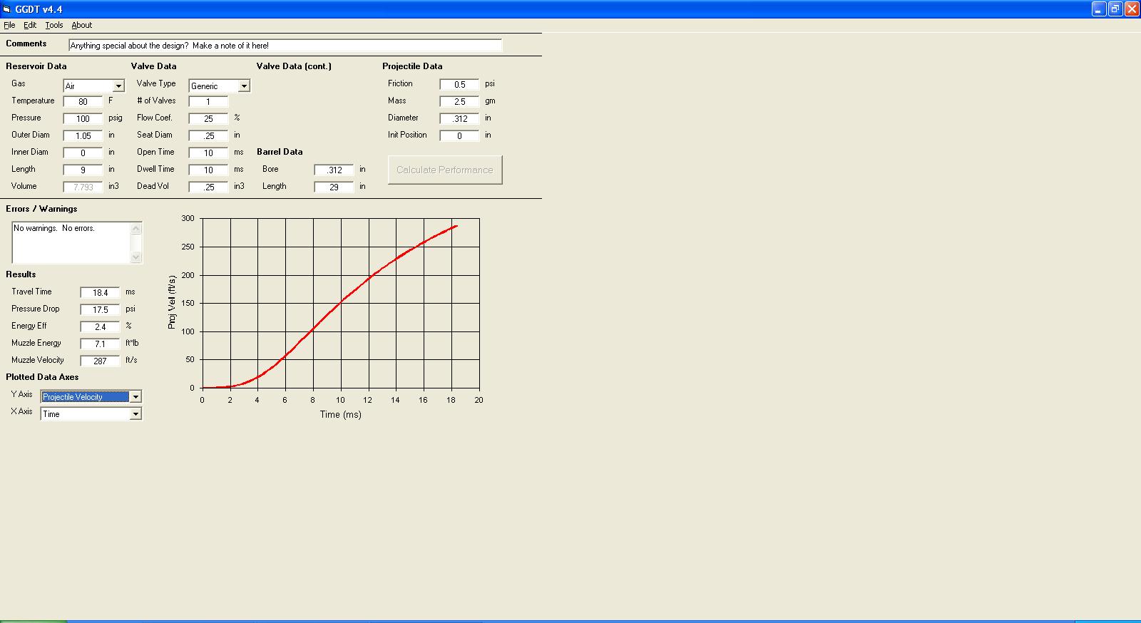

This is a model of a (likely) blowgun setup with a 5/16" barrel id. using 9" of 1" pipe for a chamber.
It should give you a better idea as to how to enter values.
This may still be a bit optimistic, but not too far out.

First of all, the one modelled by Gippetto actually has fairly respectable power, more than 400% the muzzle energy of a typical CO<sub>2</sub> pellet pistol.maverik94 wrote:so, in other words, This gun is gonna have very little power? Ok.....What do you suggest?
Secondly, a shock pump will let you reach much higher pressures so there's no reason to stick to 100 psi, if you go up to 200 psi for example then theoretically you should have double the power.
