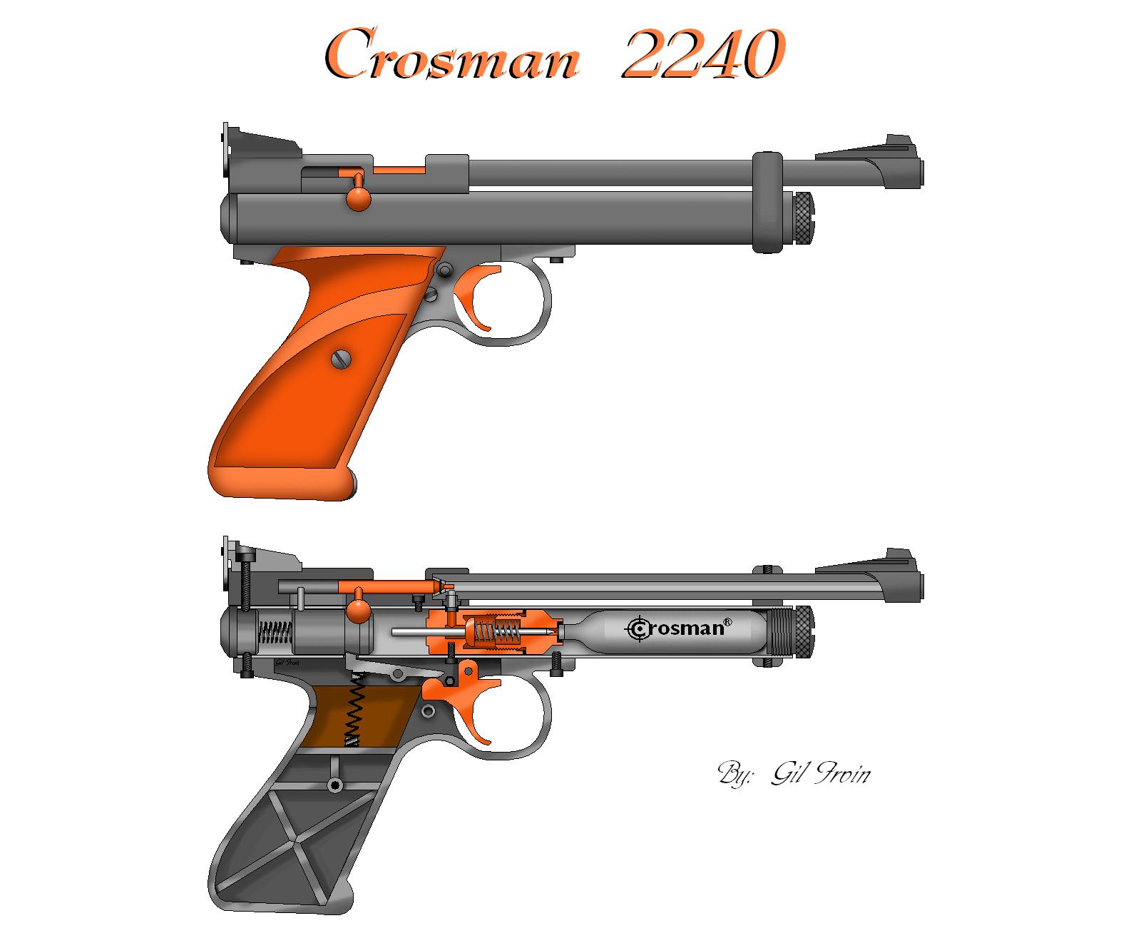

her some pictures, if you didn't understand how this work
god may help you
and
oh, that's simpler than I thought. Theoretically you could make a homemade mega-sized schrader valve, have a simple homemade spring loaded hammer...it's not so hard. One other question, when the hammer shoots forward and opens the schrader valve and shoots the air into the barrel, how does the schrader stop letting air into the barrel? Also, If I had a chamber say... 3/4" diameter and 5" long at 300 psi, how many shots would I get about? Thanks, that picture was very usefull Gippeto, where do you find those?

It's not so much the tension of the hammer spring that allows the hammer to knock open the valve, as the impact energy and momentum attained by the hammer. Mass of the hammer, spring tension, and distance traveled by the hammer all come into play. (Time to play with ggdt some more.
Hammer mass and momentum , and valve spring tension, valve stem mass, pressure, also have an effect on valve dwell. This is how long the valve is actually open. Longer dwell = increased gas consumption, and MOAR power. (to a point)
After the shot, the hammer spring is essentially fully extended, and cannot overcome the spring in the valve. This, combined with the pressure in the valve, allows the valve to close.
It's not quite a schrader, but you are getting the basic idea.
There's no reliable way to calculate how many shots you will get out of that particular chamber. There are too many variables, just build it and find out.
A wild arse guess (Literally pulled from.
)...5 shots in 6mm caliber
I found that diagram and others online. Google is my friend.
