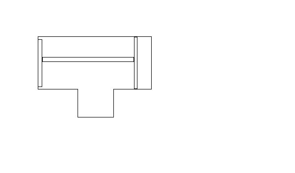

Has anybody tried a toolies piston in a tee configuration? That would combine better flow and cut down on weight because the rod isn't as long.
Something like this
Something like this
- 2 minute paint pic
- tooliestee.JPG (6.76 KiB) Viewed 3127 times
gun is drying right now. from our test fire it is going to work. will know for sure tomorrow. tomorrow night expect it to be in the gun showcase with alot of pics and a write up

Yep - That's the exact idea behind my "palindrome" piston. Works great! I have it employed in my "1 gallon" lancher, and a similar design in my "10 gallon" launcher.daberno123 wrote:Has anybody tried a toolies piston in a tee configuration? That would combine better flow and cut down on weight because the rod isn't as long.

Good to hear! I'm thinking about going even smaller and using it in conjunction with a pop-off for a full-auto airsoft gun.mobile chernobyl wrote:Works great!
