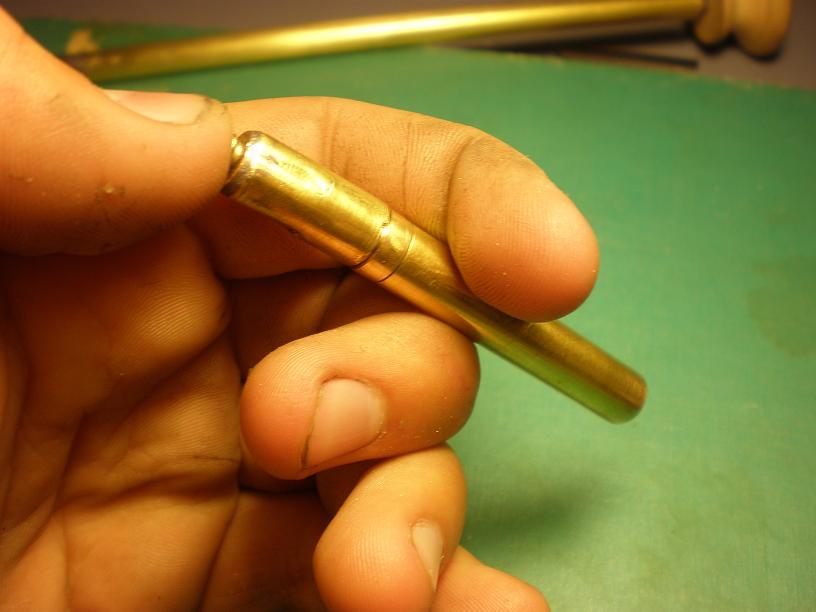

I saw Jook's keychian gun and decided I needed one too. I had pipe left over from my brass pen gun so I decided to build it out of that. Its nothing to special 2.5" long about 8mm wide with a 3mm barrel. I built another firing cap similar to the one on my larger pen gun.
Shortly after building it I looked at another pen gun and saw this that JSR posted and decided to try my hand at building a small pump. It was surprisingly easy about an hour at the drill press and I had a floating oring piston that works great in my 8mm brass tubing. Im not sure exactly what pressure it can achieve but same gun firing same ammo penetrates much more using my pump as apose to a bike pump.
I normally fill the gun with about ten pumps from my small pumps, after that the power increase isnt significant enough to warrant more effort.
No damage pics right now but I got a nail to go through both sides of a coke can.

how I hold it to fire it

Good job, what's the stroke of the pump? With info like that we could give rough estimates of pressure.

what did you use to seal the barrel on the chamber ,epoxy putty?

Everything except for the schrader is soldered together, I epoxied the schrader becuase I would have melted the piston if i tried to solder it.

Do you think you could take a picture from the barrel side(at the barrel)?
