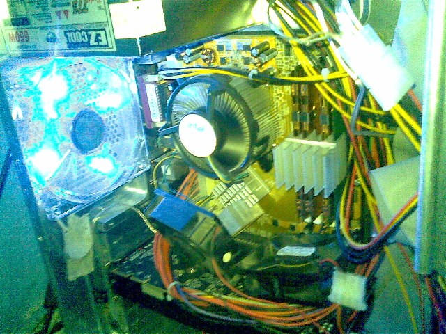

I'm a big believer in keeping the temperature down, check out the ghetto setup on my PC :D

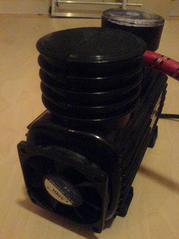

I have some experiences with these compressors, so I thought it would be a good idea to share this relevant information here.
First off: those things suck.
Flow is crappy, pressure is too.
Instead of the 250psi it promised on the package it delivered under 200 psi according to its pressure gauge.
In reality, it merely produced 150psi, due to the cheap "bragging" gauge, which shows about 120% of the real pressure. I have found that almost all gauges from cheap bike pumps and compressors like these to be very inaccurate, and are always exaggerating pressure readings. "As if" the cheap pump could provide that pressure.
I built a small pc fan in it though (it runs on 12 volt so...), it tends to get very hot. Simply dremeled a hole and put the fan in. Never really used the thing though.
