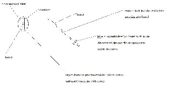

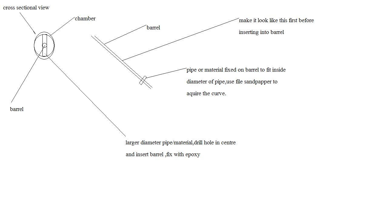

something like this maybe==

Most people use some sort of barrel support with either holes in it or only making the support take up a small cross-sectional area to support the barrel. I cut a cork in half, trimmed it a bit and glued it at the end of the barrel inside the chamber.Spooky wrote:I'm working on a coaxial at the moment, just successfully cast my epoxy piston.
The problem I'm having is that my copper barrel is sagging inside inside the chamber. This will obviously cause sealing problems as it wont line up correctly with the piston.
Thought about sleeving the barrel with something inside the chamber to keep it rigid but this will decrease my chamber volume too much. I also thought about a drop of epoxy between the outside of the barrel and the inside of the chamber at the piston end, but I'm worried about how this will affect airflow during firing.
Do I have any other options?
Some people make a circle from some rigid material and then cut out 80% of the middle, leaving only necessary supports, so air can still flow past it.
