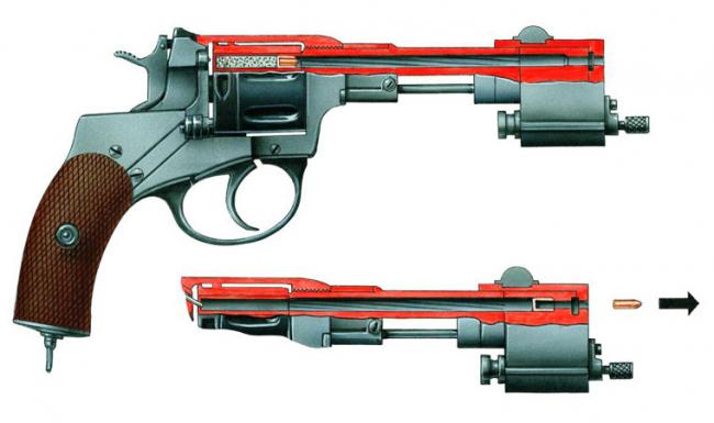

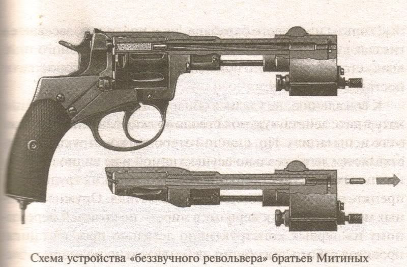

Found another real world example, an early Russian system made for the Nagant revolver, the "беззвучного револьвера" or "Bezzvunogo revolver". It's a 0.22" projectile in a 0.38" sabot, and the muzzle has a revolving drum which allows the sabot to be ejected for another shot.
Normally revolvers cannot be suppressed effectively because of the gap between cyliner and barrel, but the unique Nagant action forces the cartridge forward on firing, allowing the brass to expand and effecively seal the gap.
